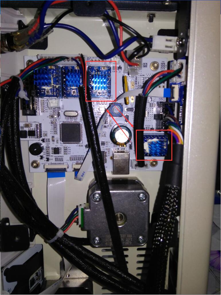

Re: My printer can only extrude but cannot retract
Have you tried to swap the motor driver board A4988?
I have not tried doing that but I will do so now. Will update with the results
I swapped those driver boards, but the result is still the same. I will only extrude using either of the buttons

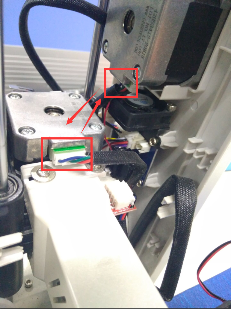

Have you tried to check the lines of motor cable
Yes, I found the post about fixing the non-working extruder and I checked the cables. The colors match exactly to your picture
You can swap the wiring of X-axis motor and extruder motor
- E180-SWAPCABLE.png (928.53 KiB) Viewed 11926 times
I tried swapping those cables, but the the cables are infact very different and I cannot really swap them. Extruder cable is just a short jump cable from the motor to the board just under it and the z-axis cable is a longer cable that goes inside the chassis. I could attach the z-axis cable to the extruder motor but the cable would rip itself apart as soon as the z-axis would start moving.
