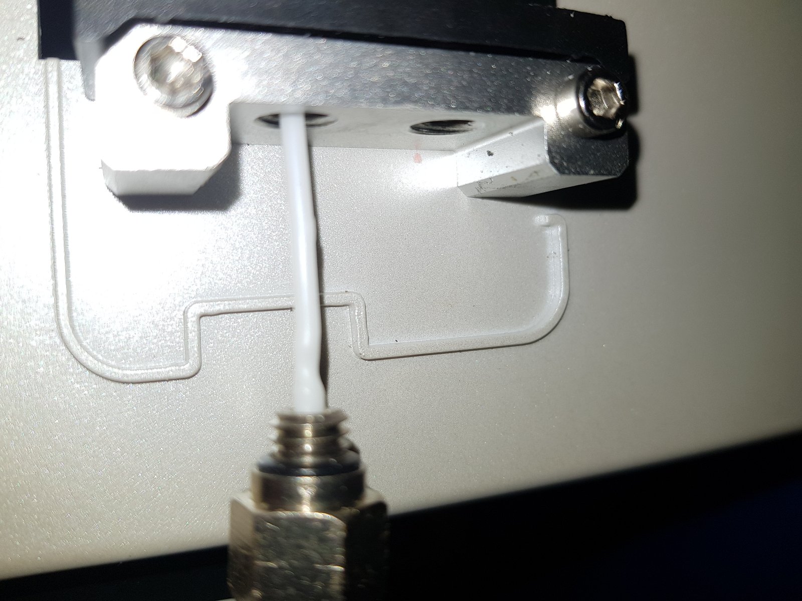

hi
have the same problem with white filament (see photos)
no problem at all with black lilament !
- filament2.jpg (317.72 KiB) Viewed 8181 times
Re: Filament stuck in the bowden tube
If it's inland Filament from Microcenter, that is the main problem... that white pla is gunky as fu*k... I have to print at 210C to keep it moving smooth and it always clogs the head when I change..
You can use a skewer to clean the line after you remove it.. or get another one from ebay or wish.
