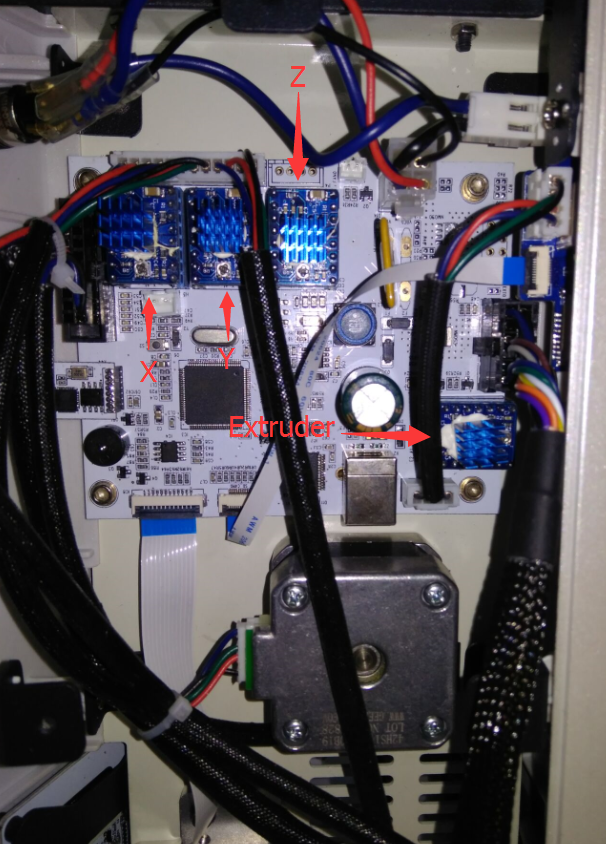

1.Remove the cover of the bottom
2.Ensure the noise from which motor.
And then swap the A4988(X-axis motor and the noisy motor)
