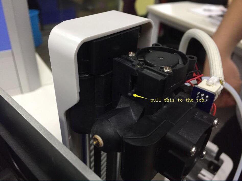

I don't understand how to change the nozzle (to use the replacement part) on the E180. Is there a special trick to do this? I'm not seeing anything that I can pull/push to release the nozzle.

I had an answer from Jocelin from Geeetech, so I'm sharing the pictures with you.
The bit to pull didn't move when using my fingers, so I thought it couldn't move. Using a tool did the trick, I could pull it without problem and remove the nozzle. I didn't need to change the nozzle after all (wasn't cloged or anything) but I wanted to know how to do it...

A more detail:
You should heating the nozzle up to 200C and then remove the filament off
Then you can try it and remove it off

Hello. I cannot pull up the lever. What tool did you use. In case the lever is stuck may I use a bit of W40?
