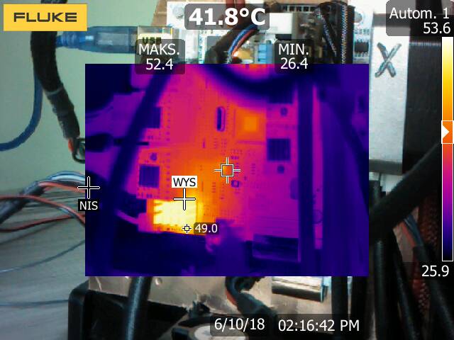

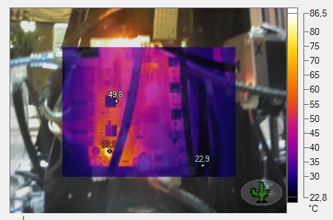

My conjecture has been confirmed. The linear stabilizer that powers the fans must dissipate a lot of power. Due to the above it becames very hot, which will definitely shorten his life ...
By tapping it with your finger you can get very burned. I examined the high temperature of this toddler with a thermal imaging camera.
You can see the results below.

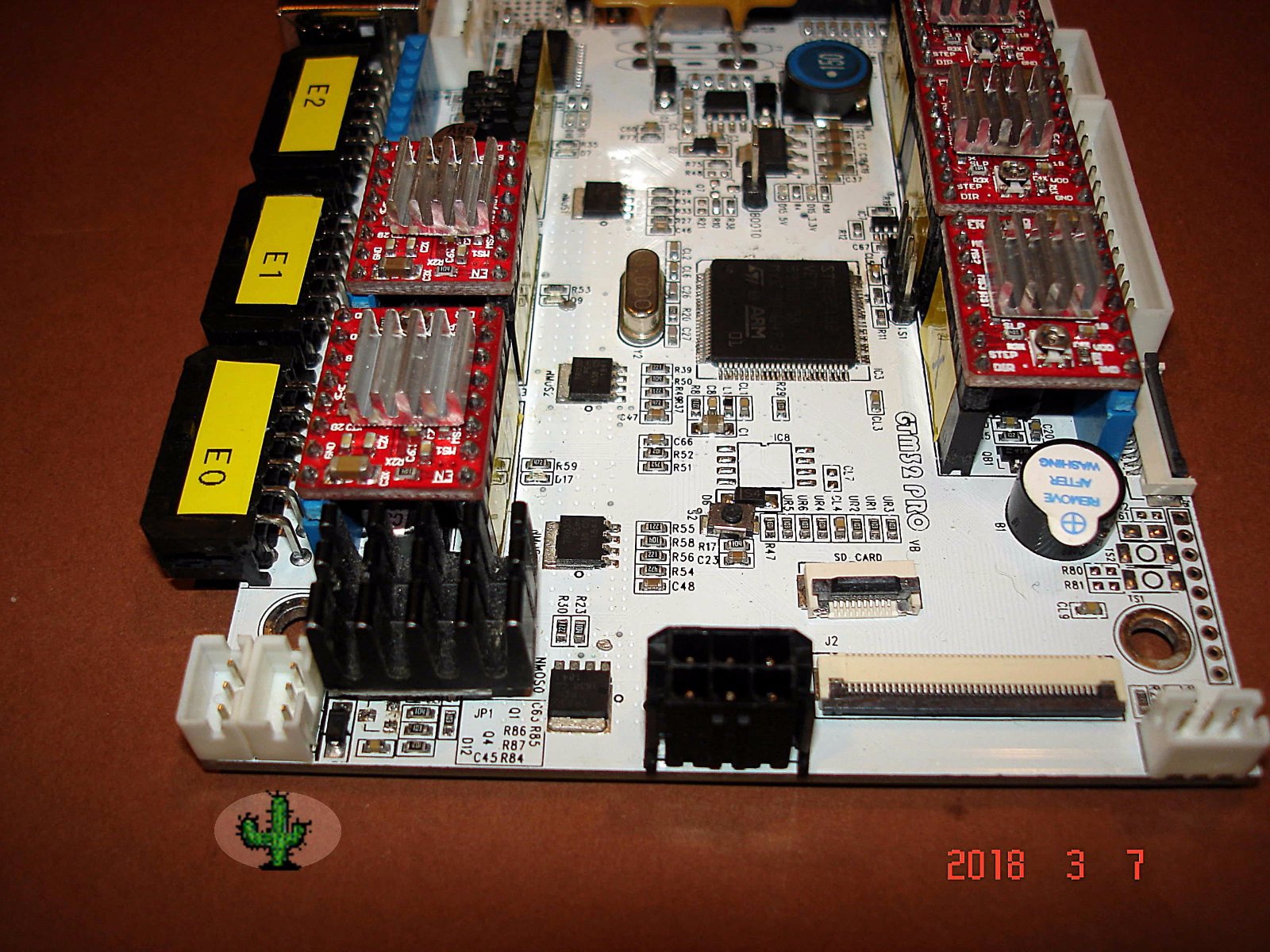

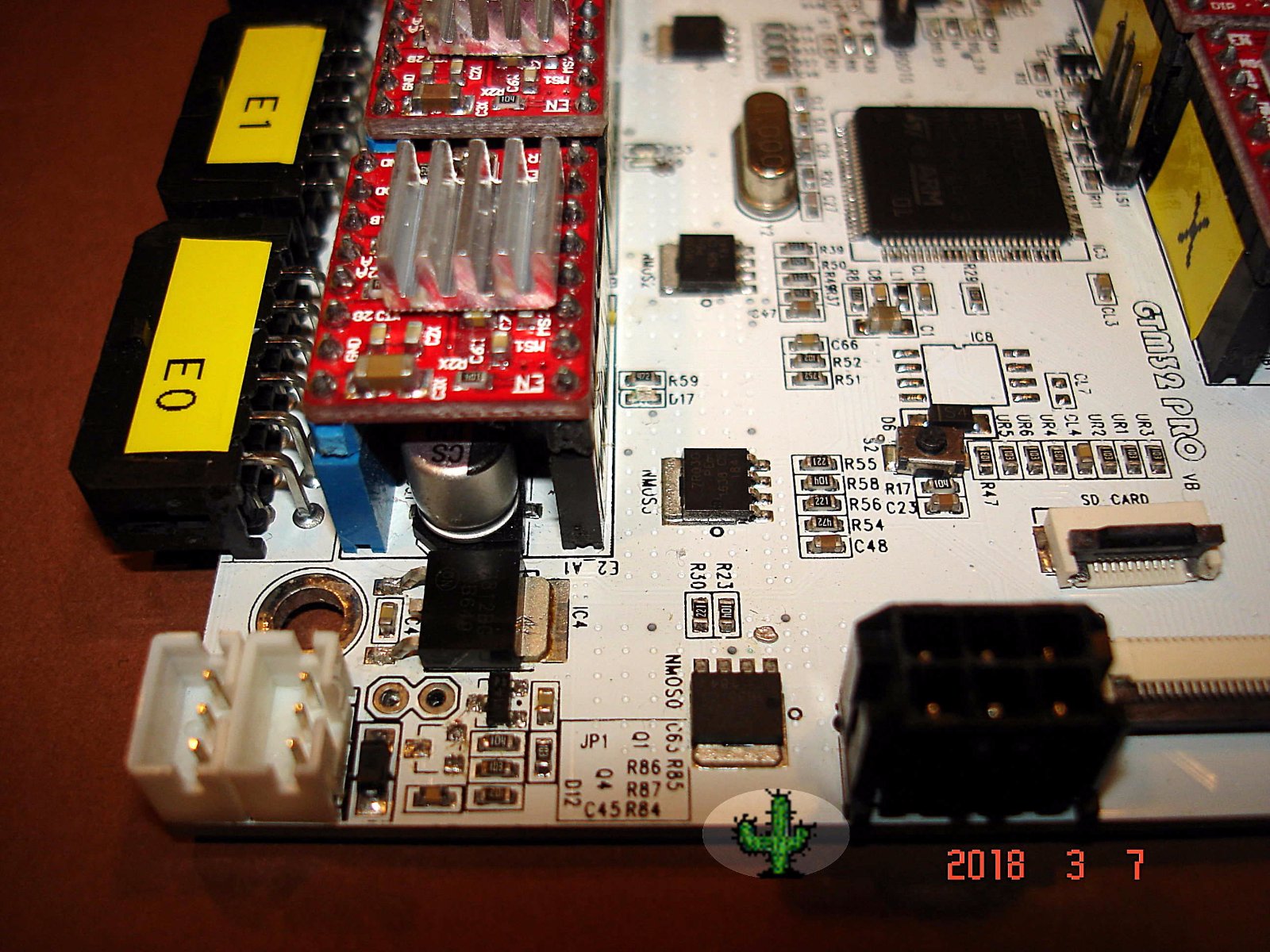

That's why I de-soldered a goldpin from the controller board (I think it's just a bad thing, and I do not know why it was designed) that there would be more space. Then I equipped the linear stabilizer with an additional heat sink.
The achieved effect is sensational. The radiator is also cooled by a nearby fan ;-)

[attachment=0]termo-7812+.png[/attachment]
[attachment=1]PCB_M201_nowy_radiator.jpg[/attachment]
[attachment=3]PCB_M201_bez_goldpina.jpg[/attachment]

- the linear stabilizer shines like a bulb
- termo-7812+.png (208.06 KiB) Viewed 25259 times
- heatsink recovered from the VGA card
- PCB_M201_nowy_radiator.jpg (306.13 KiB) Viewed 25259 times
- voila ;-D
- PCB_M201_ma nowy_radiator.jpg (403.25 KiB) Viewed 25259 times
- de-soldered unnecessary component
- PCB_M201_bez_goldpina.jpg (369.92 KiB) Viewed 25259 times
