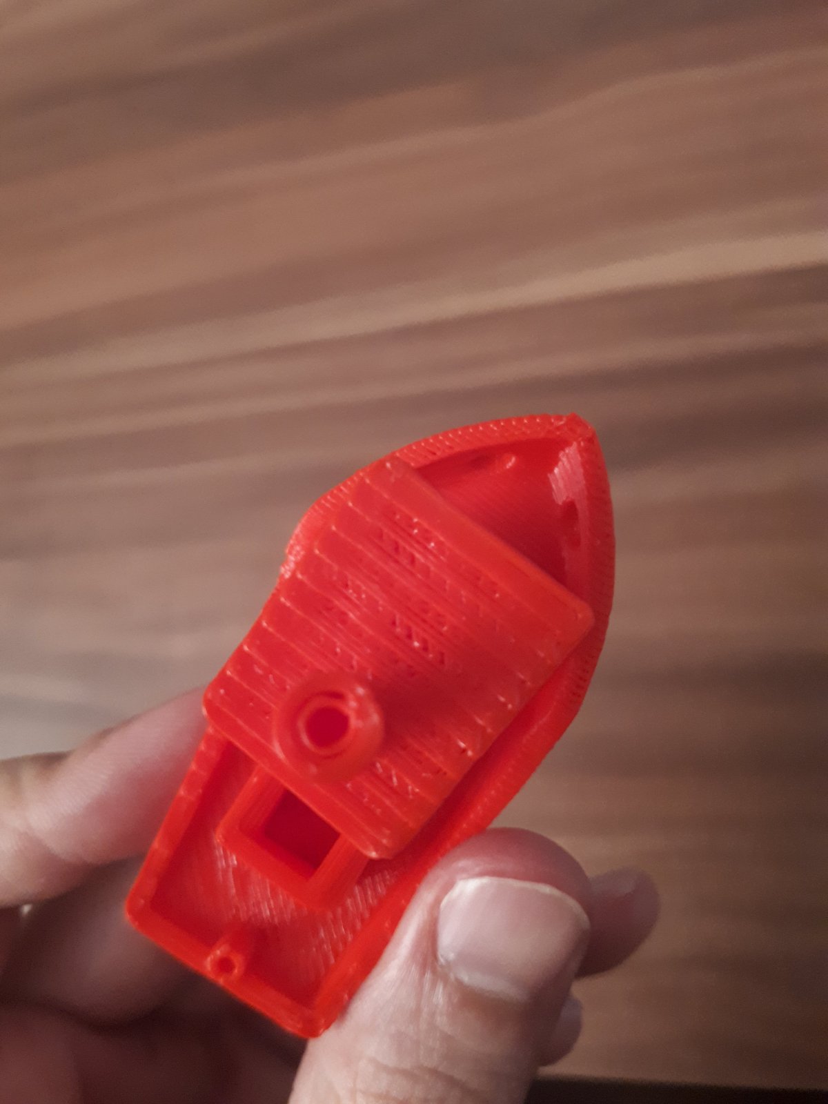

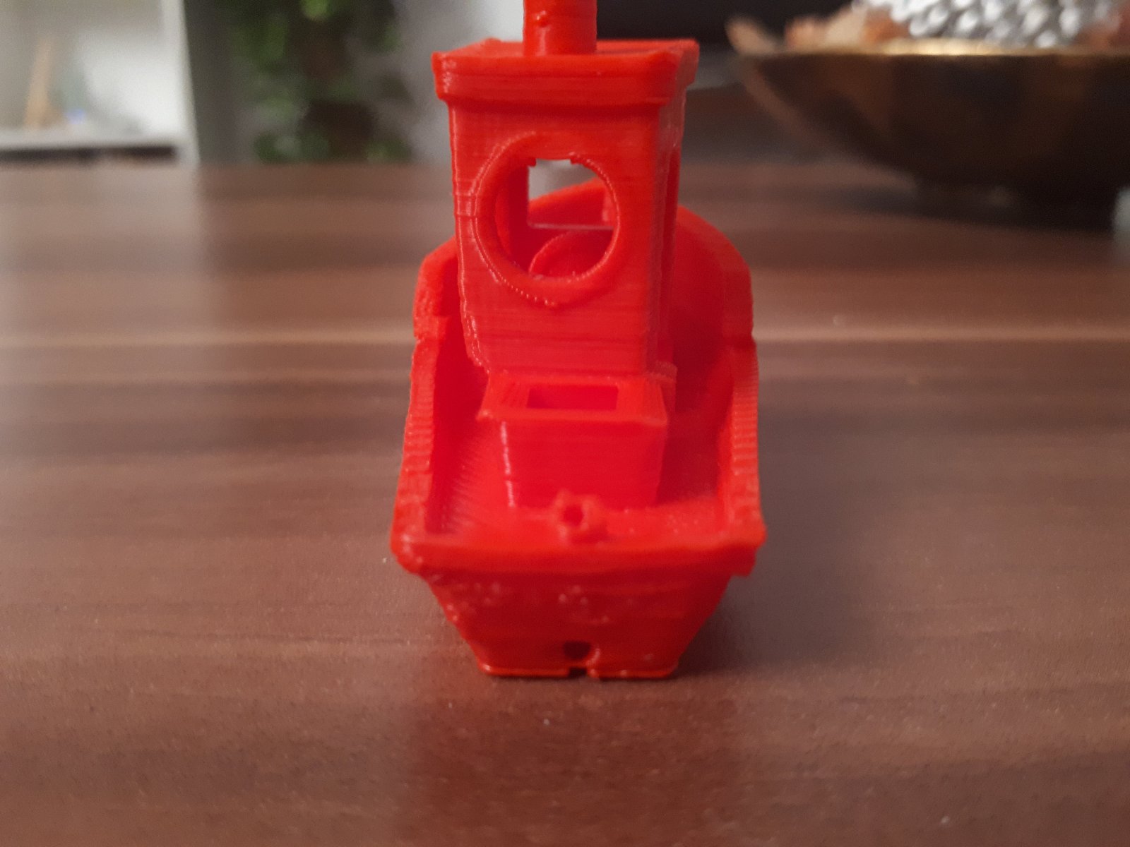

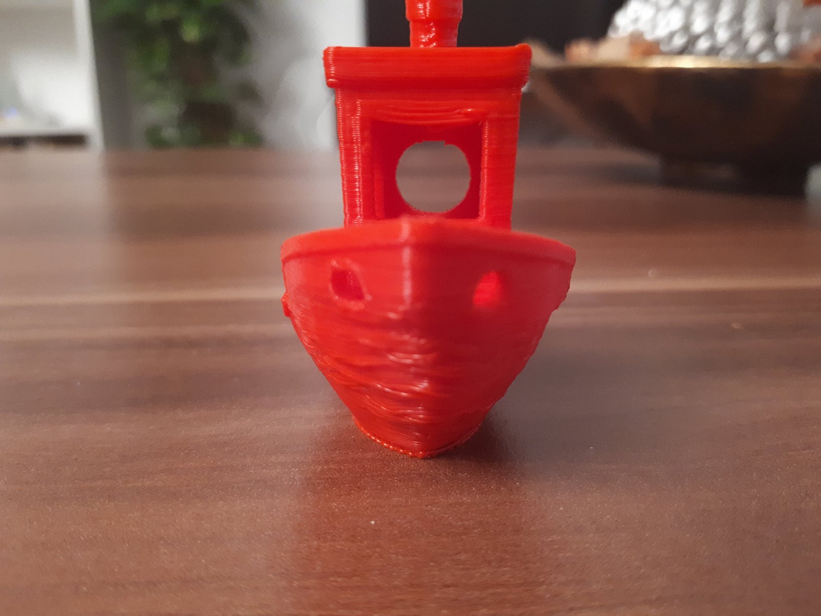

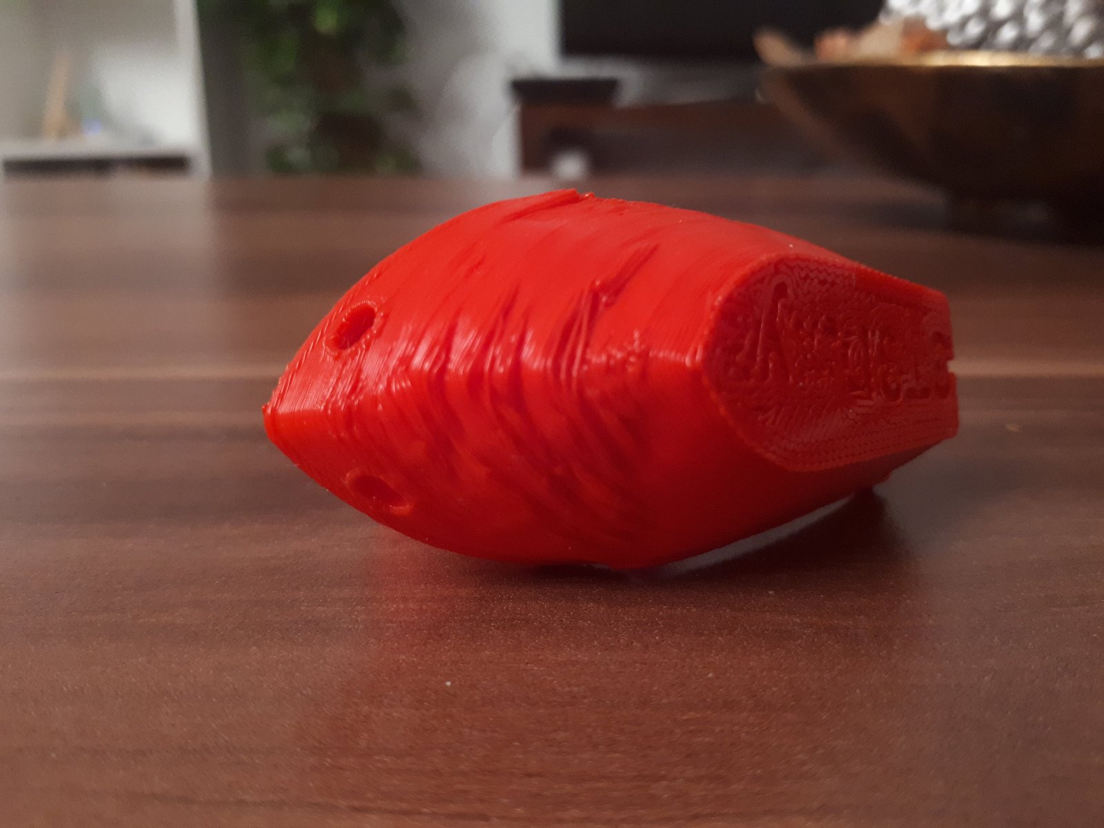

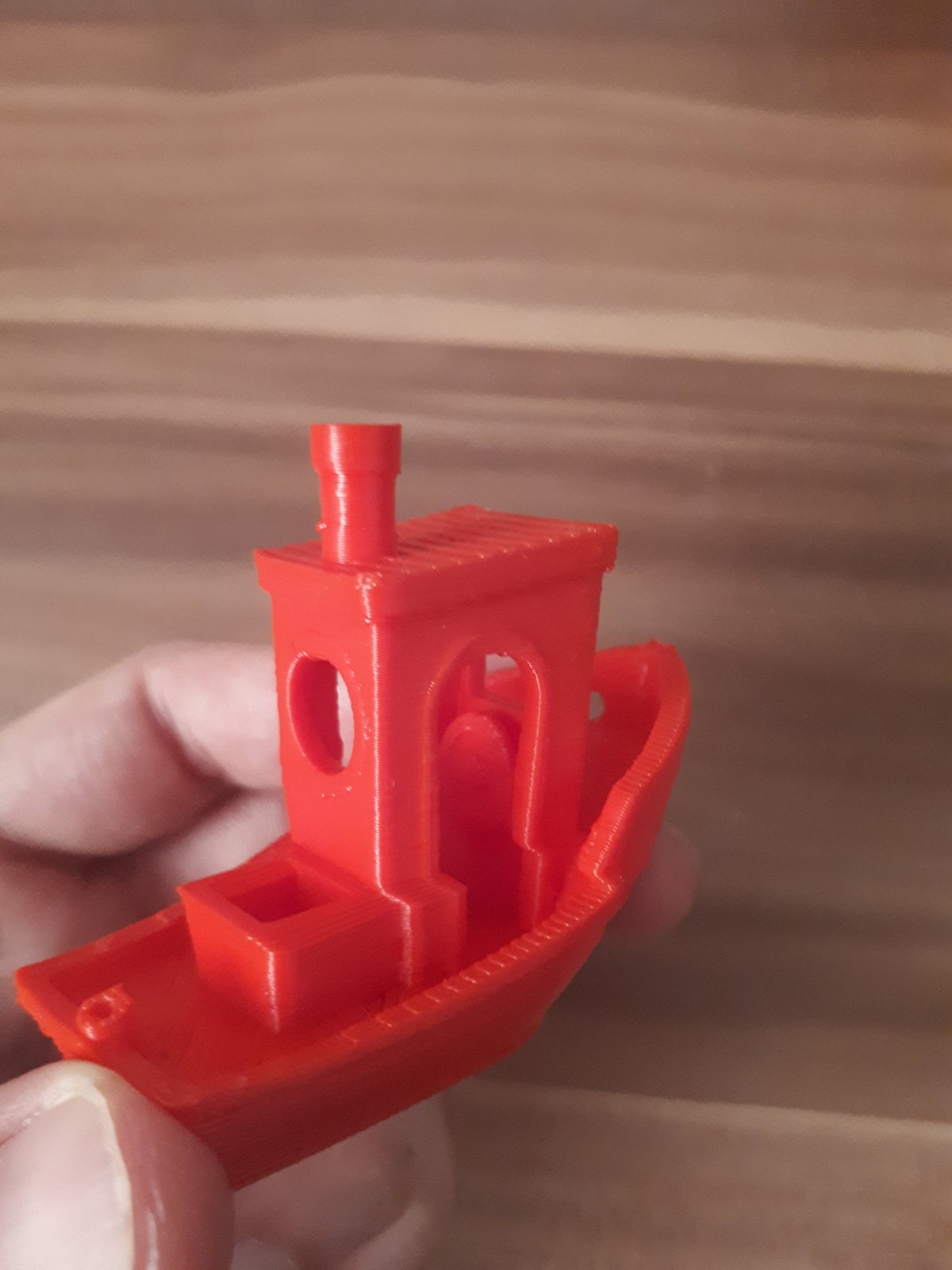

So i've run the 3D benchy to calibrate my printer. The print is overall good but not perfect at all, so I've uploaded photos here to get some feedback.
Here is what I see:
- Layers are not regular, is it because of a too high temperature?
- The upper part looks twirled as if the printer or the object had moved somehow during the print
- The infill are not regular
Any . help would be appreciated.

Re: Look at my3D benchy first print...help!
Could you upload the print setting?
And you need to tell us which slicing software you select
I use Slic3r + I3 Pro B + filament PLA 1.75 ([url=https://www.amazon.fr/gp/product/B017HA ... UTF8&psc=1]this one[/url]), here is the configuration file :
You can try to change the flow ratio to 1.1 or 0.9
Travel speed down to 120mm/s
