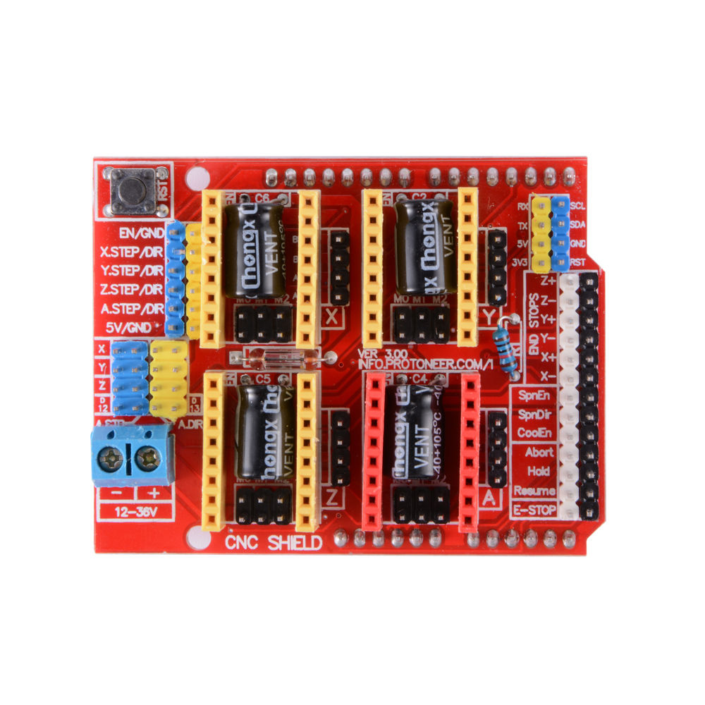

3. Use a CNC shield and wire the X, Y and Z to this shield through an adapter. This has the advantages that now you can power the X, Y and Z motors with 36V instead of maximum 24V, so you will get a speed increase. You will also get a nicer installation than the piggy back solution. The disadvantage is that you need to buy a shield. I bought this one, which I am using in my next DIY design:
[attachment=0]expansion top.jpg[/attachment]
It is a fairly simple job, but once again, you must have some electronics knowledge and soldering practice.
