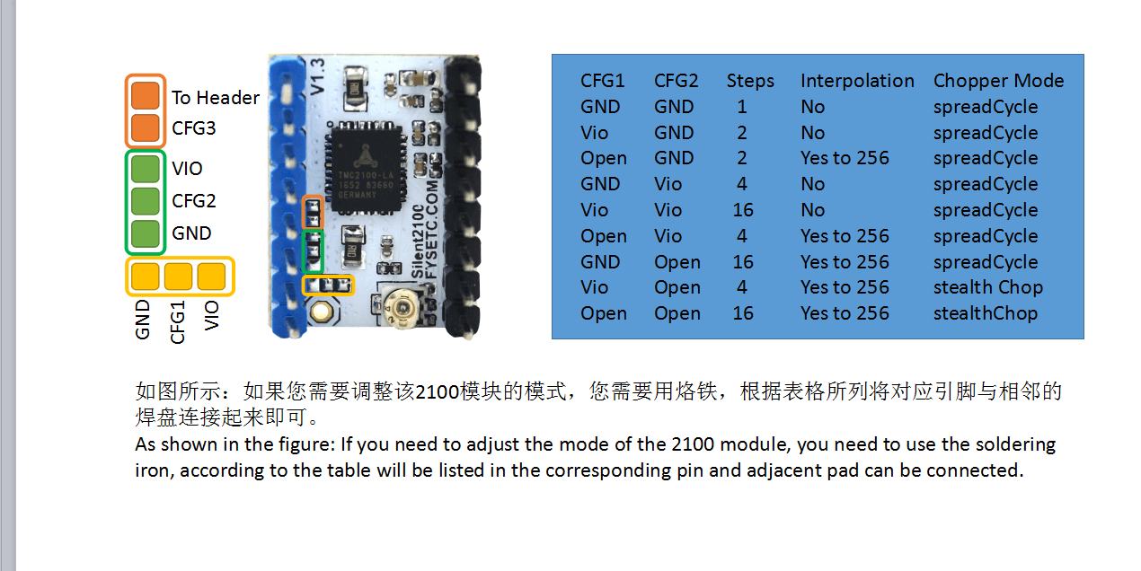

Got some from China, 4 x TMC2100 v1.3
And keep skipping steps on Y-axis and also my extruder.
Have followed various guides, but most contradict each other, and the config sheet the suppliers gave me doesn't seem to work with my brain!!
[attachment=0]HTB1mlmJo9tYBeNjSspk762U8VXab.png[/attachment]
Have used bridging wire on top, to connect CFG1 > GND (skipped steps) so in stealthchop
have set voltage to 0.8v as advised here:
https://community.ultimaker.com/topic/9 ... rs-on-umo/
Have since removed wire, and used CFG1 pads on underside.
But there are 3! bridged the 2 on right together (still skipped)
bridged 3 and wouldn't even power on the LCD!!! [either with just usb or PSU)
Wicked off all solder so back to no config.
I want stealthCycle with 256, so the table shows: lines 3,6 & 7? for CFG1
Please could someone translate the picture for me.
