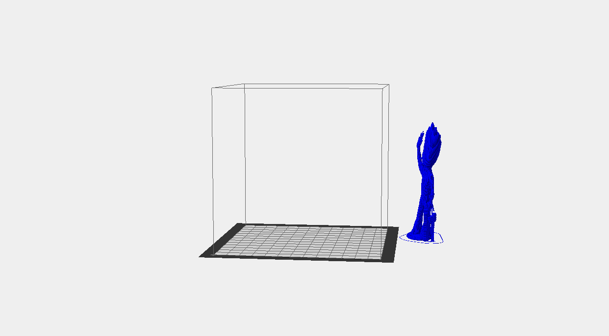

When using to save as a .gco file, where should the print be in relation to the bed of the mini3d printer ?
for some reason mine when set to the centre prints at the top edge :(
any help would be appreciated.

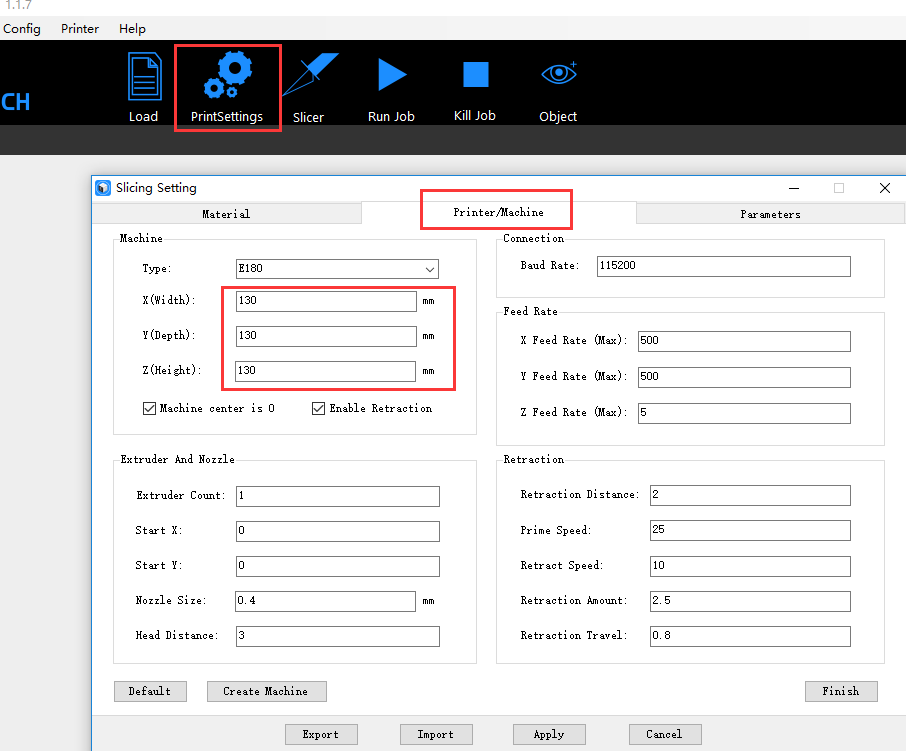

1, What is your printer model?
2, Could you show us the print settings of the EasyPrint?
3, maybe you can attach the gcode file, then we can check it.

Re: Easy Print 3d software (E180)
seems that it has gone beyond the print area.
Maybe you can check the settings and see if it is 130 * 130 * 130mm
- out of print area
 - TIM图片20180510154841.png (6.85 KiB) Viewed 9775 times
- settings
 - 130×130×130.png (23.71 KiB) Viewed 9775 times

Ahh found it thanks,
It appears it wasnt profile set to E180 once I did that it set it properly.
Thanks for the heads up .
