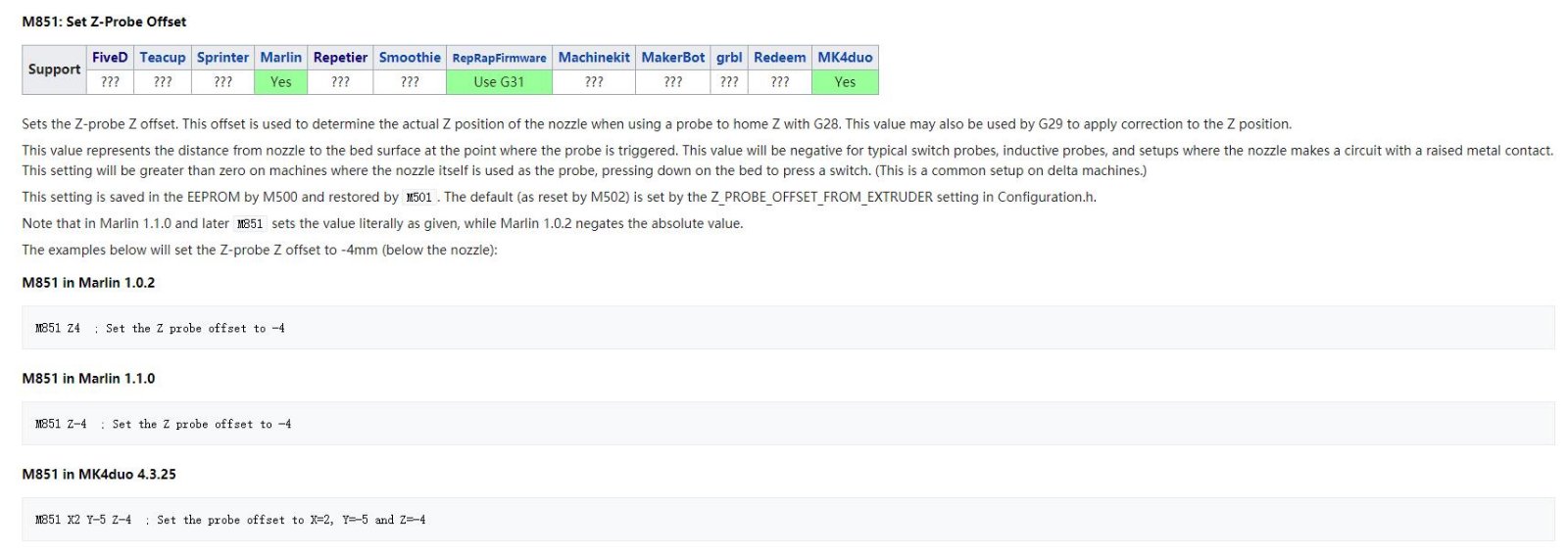

Seems that marlin doesn't support "M211" code.
I guess you can set z offset directly by M851.

- 1.png (12.2 KiB) Viewed 9454 times
