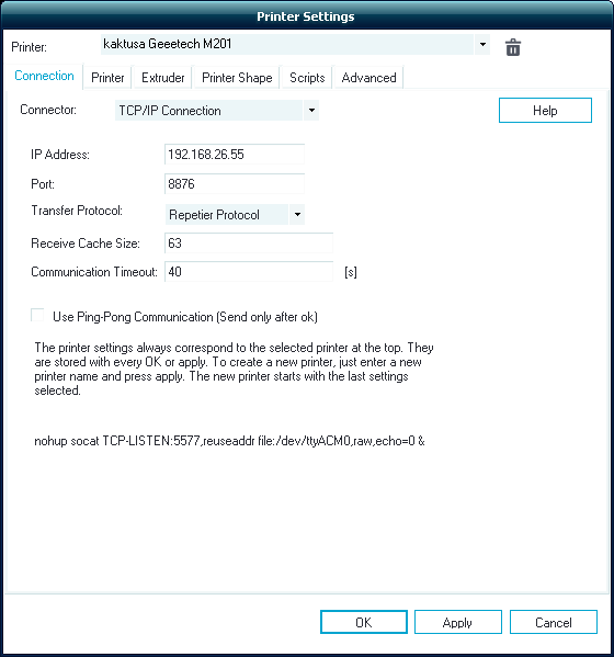

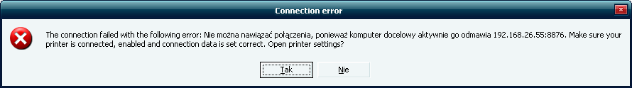

Unfortunately, I did not manage to run such a functionality. After the necessary configuration of the program has been completed, the module categorically rejects the connection.
Perhaps I don't know about something or I need staff support to run this feature.
network connection configuration

a connection rejected by the module
