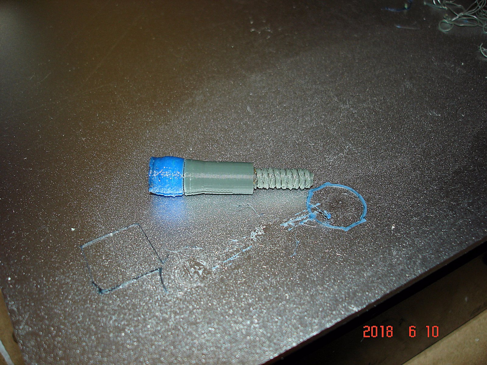

Recently I have prepared a model of an element of a bookbinding knife, which often breaks down.
With a lot of curiosity I decided to check how such an object is going to be made in practice.
I could write a story about the creation of this object because it has its own history. But this is not the place for such stories. ;)
View 1
View 1
View 2
View 2
The item was printed in two colors of the same material from one supplier (unless I don't know about something).
Printer parameters:
  • head temperature (hot end) 250°C
  • working table temperature (heat bed) 95°C
  • Layer height 0.2mm
  • 100% printer speed
  • diameter of the nozzle gap 0,4mm

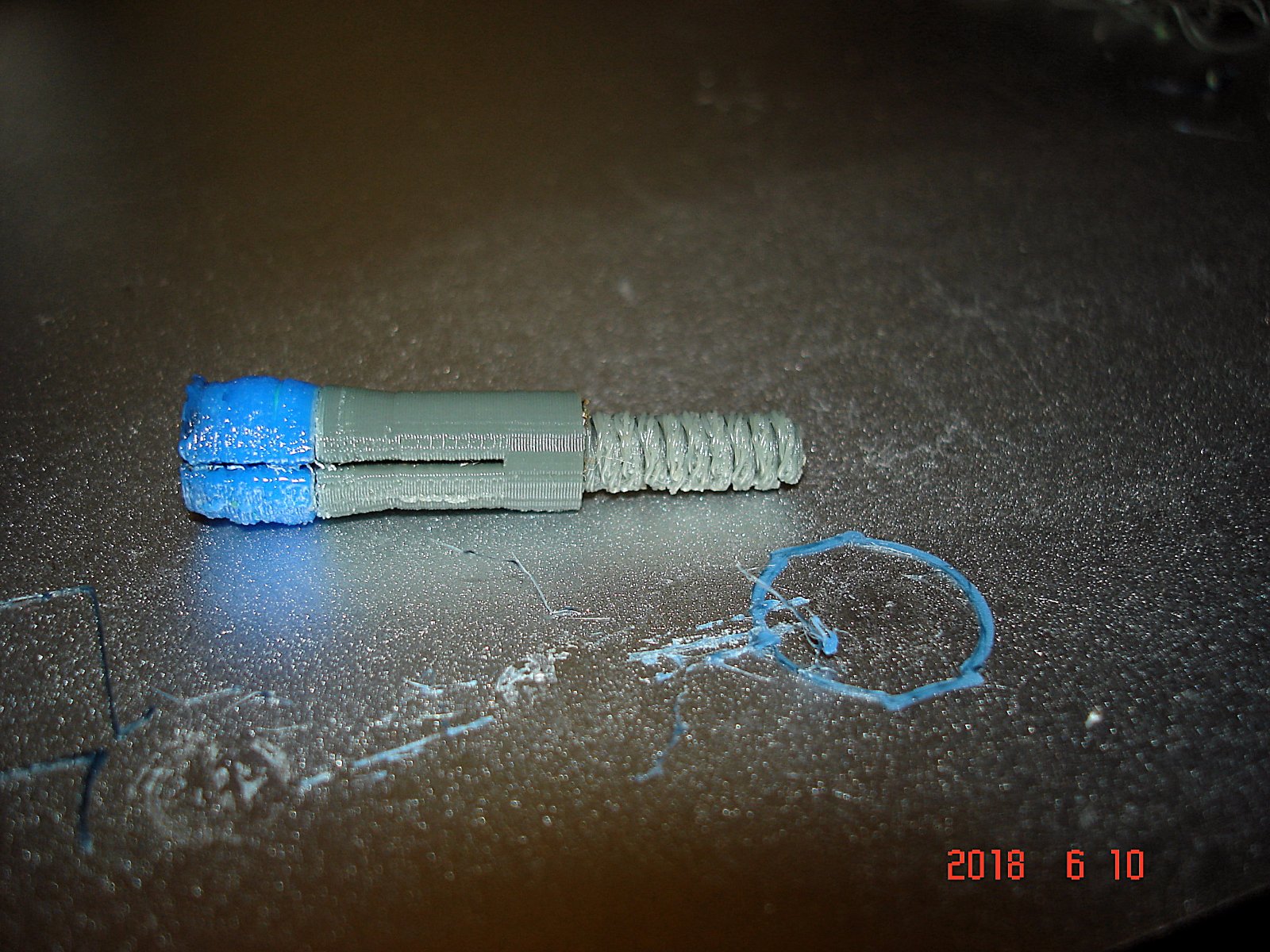

You can clearly see that the set temperature was too high for the blue filament.
As a curiosity I would like to say that the cohesion of these two materials is weak.
When I plugged the blade into the slot, the blue part broke away from the rest.
Already somewhere in the forum I told you that despite the same type of material and identical supplier the filament will have different properties for each color.
That is exactly what I saw here.
The pictures show that the bolt was also designed. This is a metric M6 thread, so it's small enough.
I was very curious how its performance would come out in reality.
Well, there was ... that's what I can say about it. :lol:
I expect that if I used a nozzle with a smaller hole and used a layer of 0.1mm the thread would come out better.

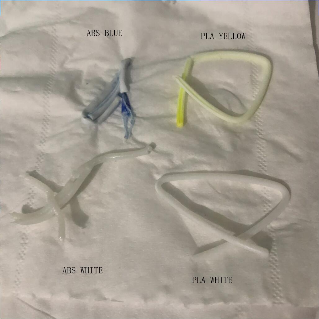

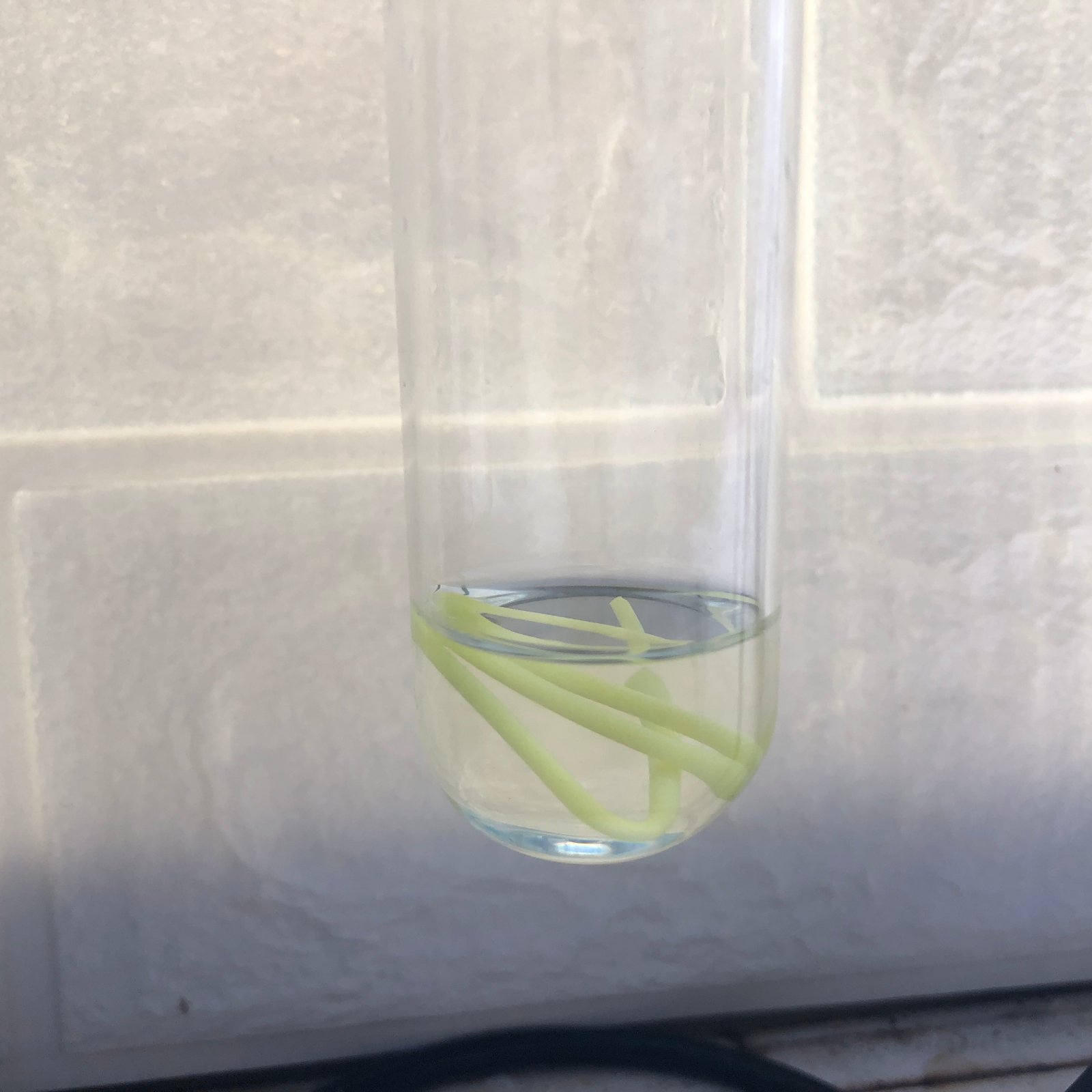

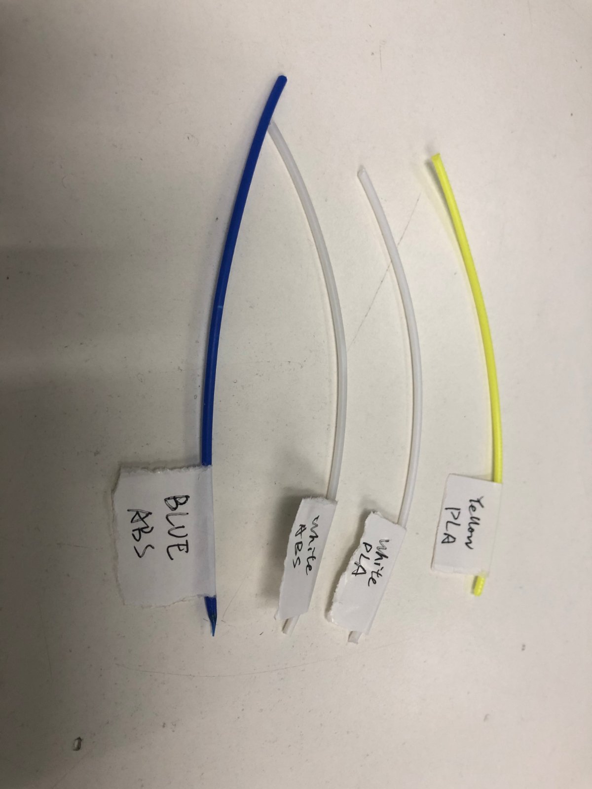

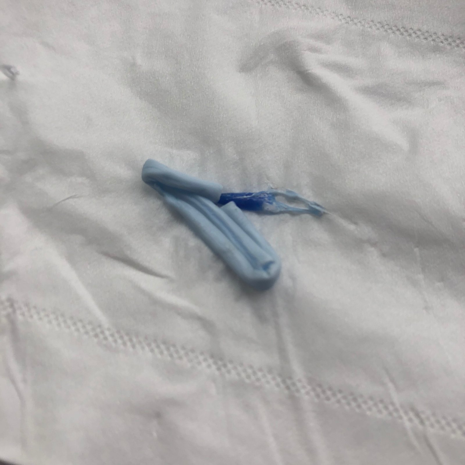

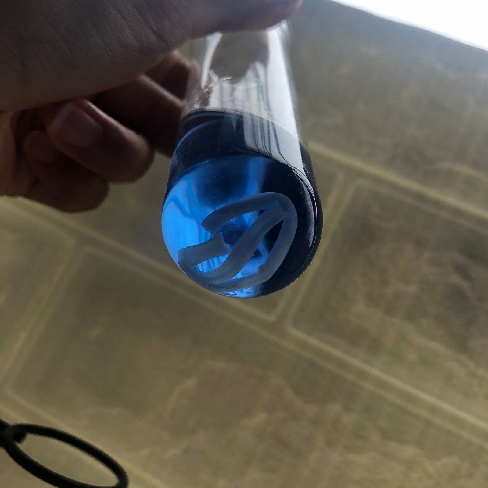

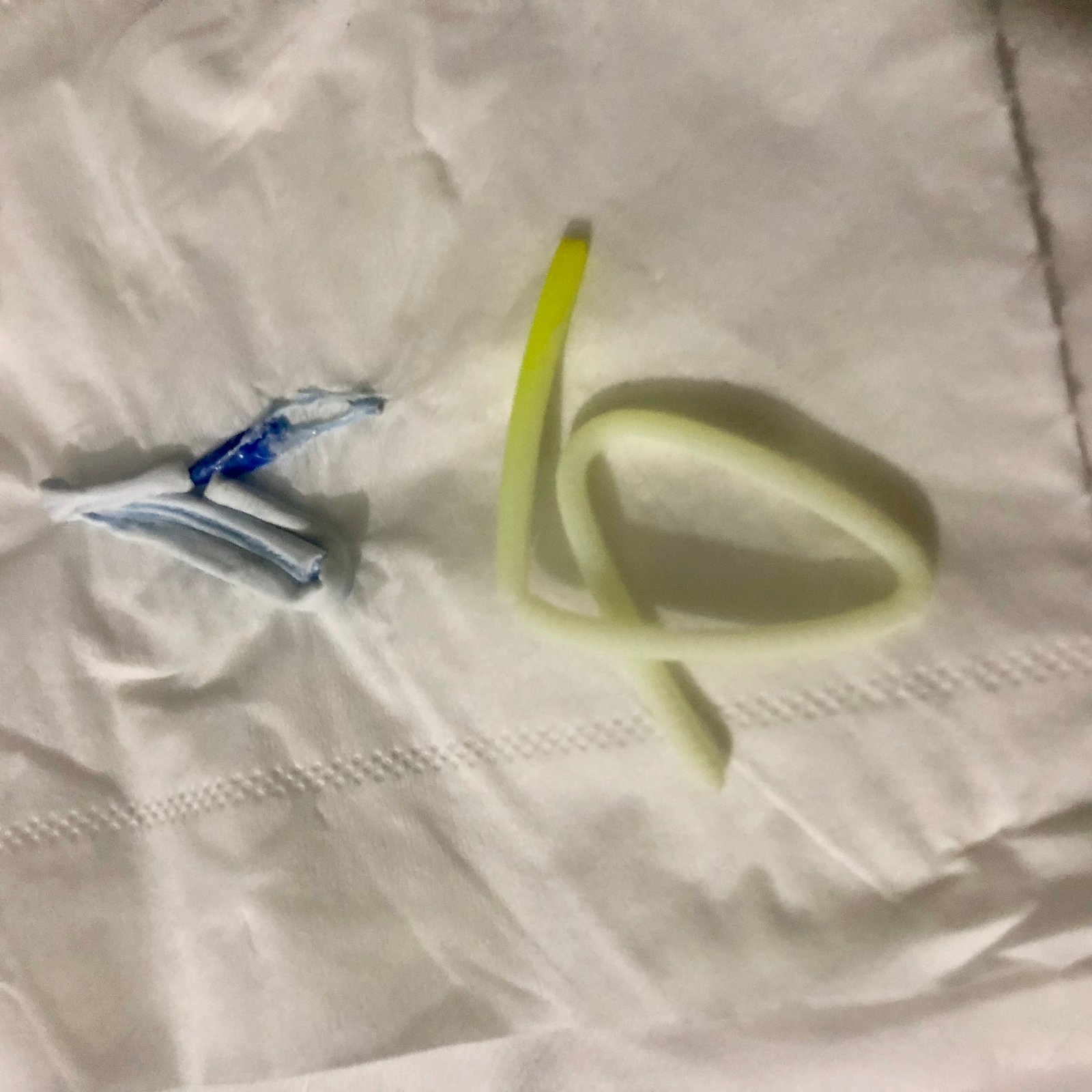

I do did a rough experiment this week, soak ABS and PLA with acetone.
Because I have a limit amount of acetone liquid, so I folded the filament sample. But they still looked quite different in shape after several hours of soaking.
Take a look at the pictures below.
Prepare filament
4 kinds of filament with length in 10mm
After 8 hours of soaking, ABS blue looks like:
PLA yellow:
The liquid becomes yellow(not that clear in the photo though), I think is the pigment got off.
But the shape/form wasn't changed a lot, compared with ABS.
And the final result:
All filament was soaking over 8 hours BTW.
Just out of curiosity.
Hope that will help. :D
_kaktus_
Posts: 1260
Location: PL
Contact:
Re: Filament test and printer capabilities.
Post by _kaktus_ »
Hello Gingko.
This test is great. Thank you. :D
It is clear that the PLA filament is almost indifferent to acetone. Compared to ABS, of course.
