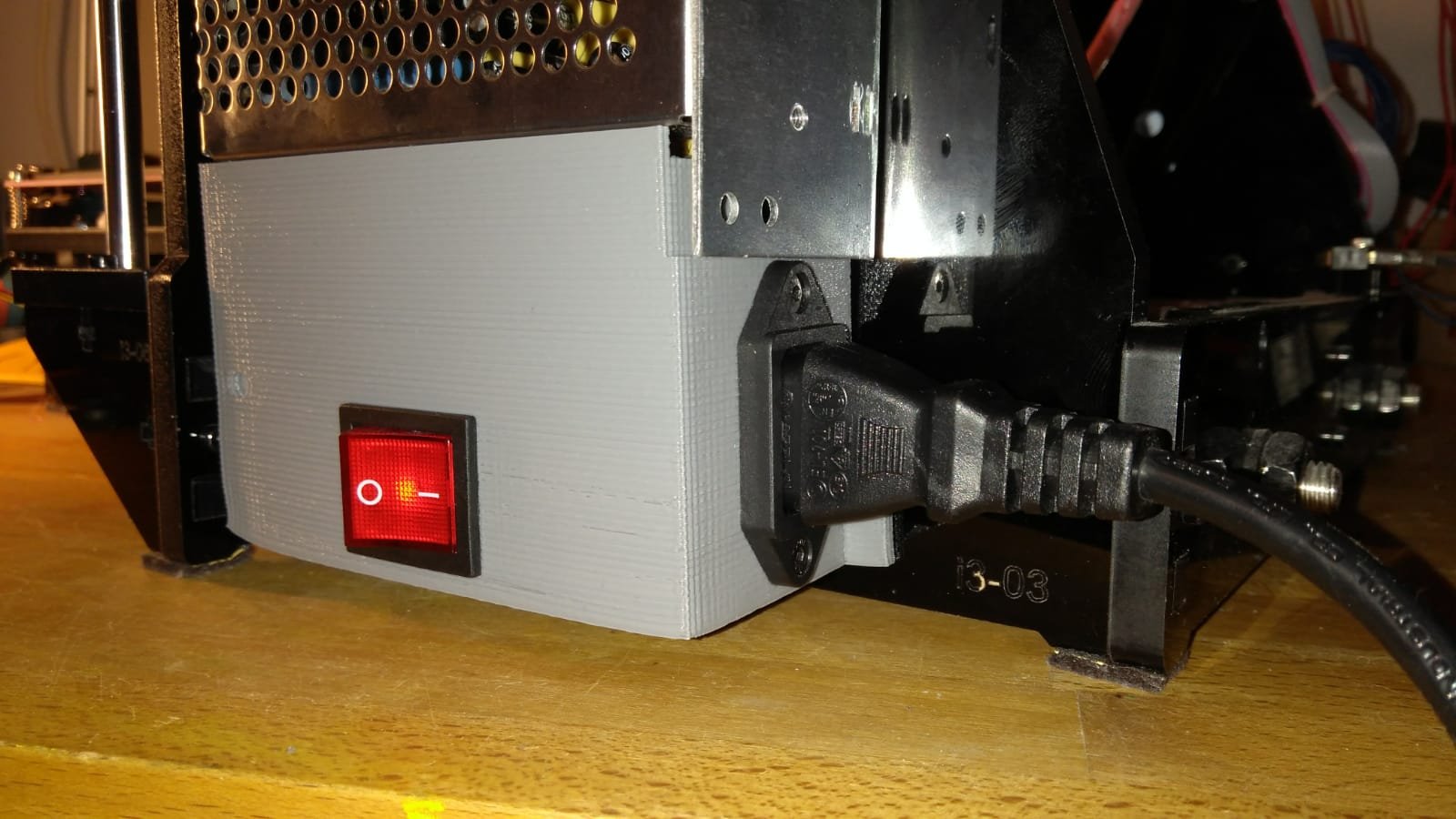

To resolve the security issue (There are electrical parts which provides 230V electric voltage!) I printed this PSU cover for my I3 Pro printer, provided by jdobry:
This was the first print, looks quite good.
The second print was not so good, had to change the nozzle first and printed with higher temperature, 205°C:
Third print, even better, now again like the first print with 195°C.
I strongly recommend to apply this case to Your i3 Pro B/W/X models, because the electric installation is a real risk!

Here is now the Version V5 for the i3 Pro C 250W PSU:
Remark: On the picture, this is a beta version V4 of the design. The final V5 fits better on the right side and contains some more enhancements.
https://www.thingiverse.com/thing:3429339
