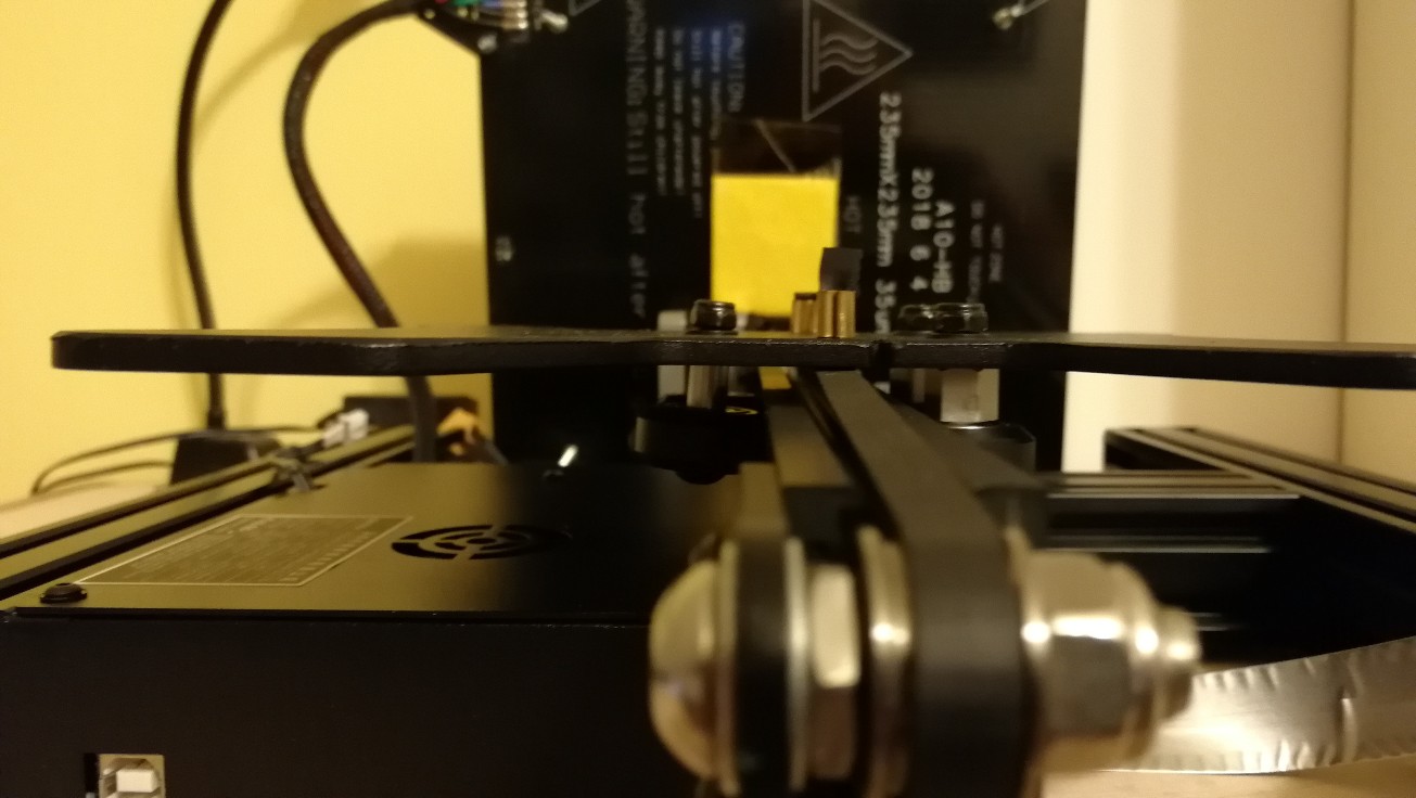

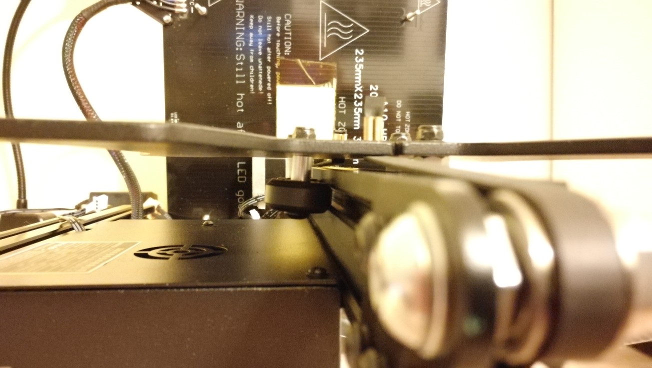

I have received one of these defective A10. The aluminum profile of the guide of the base plate has a dent or notches. The rolls stay about every 7cm.
It is not my job to rebuild that somehow. Is there a corresponding spare part or should I send the goods back, is there proportionate money back?

You need to adjust the 4 wheels. From video seem to be too hard and not in axys

Nothing to adjust. Drillholes are misplaced. Bed ist Not plane. I can only adjust between loose and wobbly or hard and stiff.

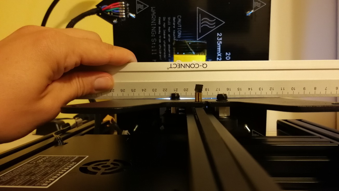

doesn't matters if there is a light there. The important is the bed.
I notice le screw on left are not perpendicular.
You have to adjust these left side screw to be perpendicular,and after the right screw and set up with eccentrical

you can write it thousand time, but there is nothing to adjust
the drill hole for the wheel axis are misplaced several Millimeter
if i tighten it the bed slide plate is mor like a bow, but not plane
in result the the for adjusting screws for bed Level are Standing more and more non vertical
