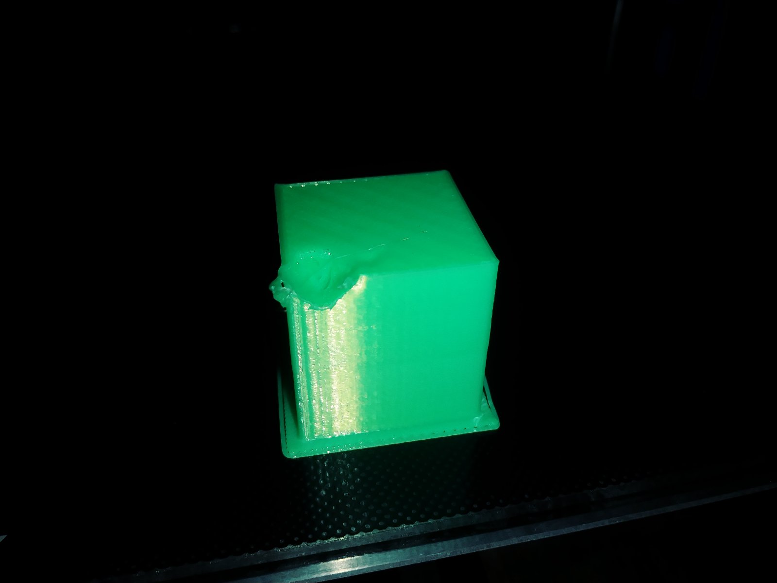

Also...I printed a calibration cube that I modeled myself and it printed great (even without part cooling), but at the very end of the print the z-axis drove nozzle into my pretty first print. I checked the gcode output from Slic3r and it had the end routine code present that should have lifted the z after print, not shoved it into part.

Looking at the piece on bed,it's like a z axys drop down

The z axis drop was due to end gcode command generated by Slic3r. It tells Z to drop to 5mm value. I used G91 relative value first and now it lifts 5mm after print no matter how high print is.

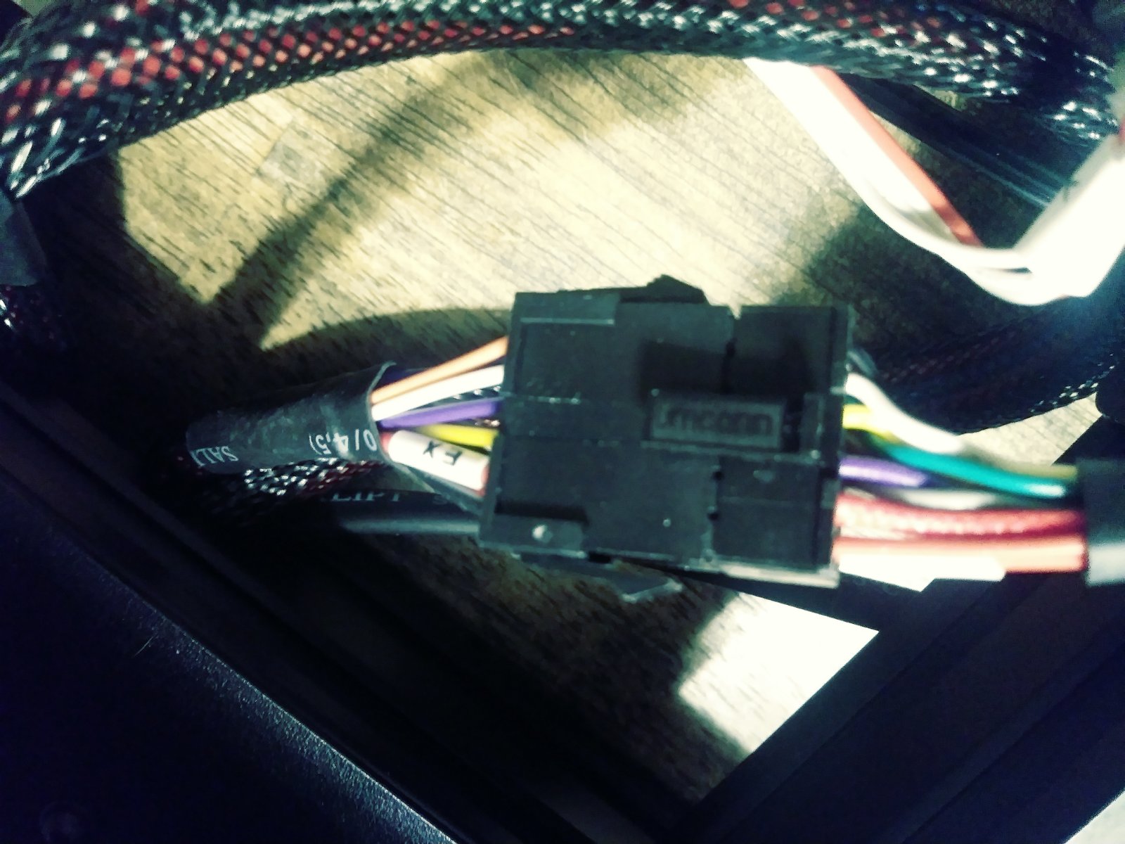

See attached picture. Yellow and purple parts cooling fan wires coming from board are in different pin locations (reversed) when they leave connector harness and go to fan itself. Is this reversal the cause of my fan not running automatically through slicer settings or using control knob? Please advise.

In my printer the connections are the same,yellow purple with purple yellow,so the problem is not there.
