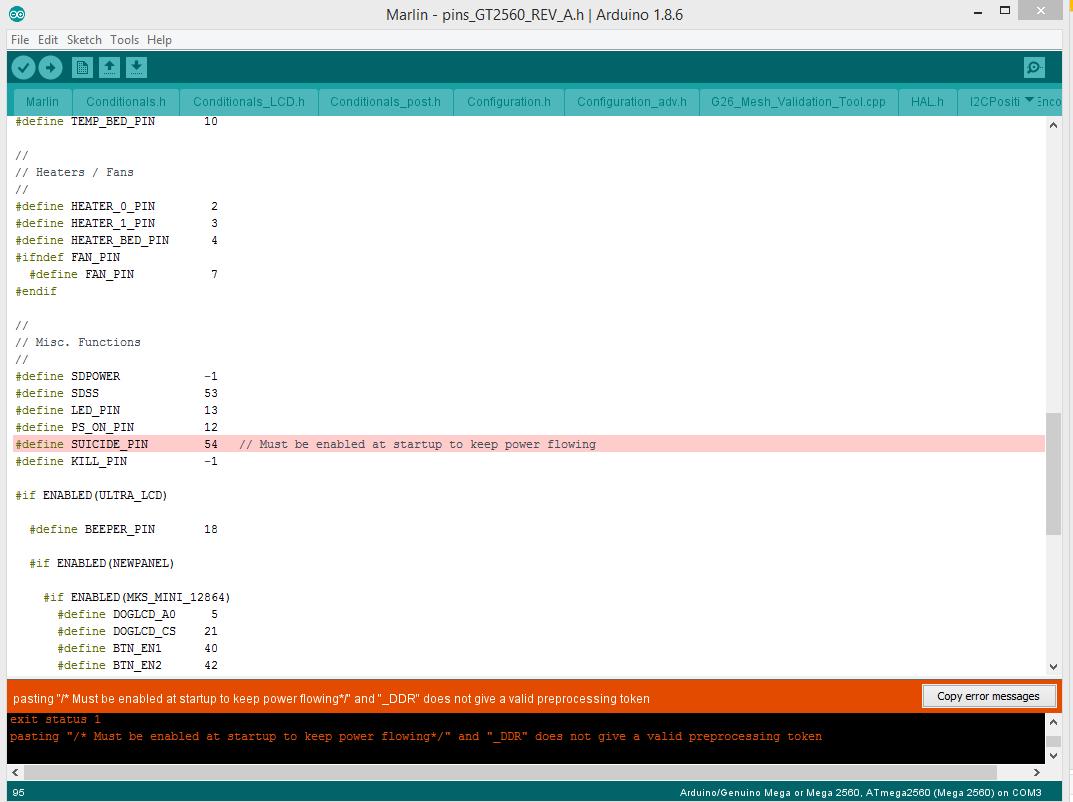

Hi guys, I'm beginner so it's very hard for me understanding printing software process. After opened configuration.h file for my motherboard in Arduino I verified it before uploading it but I received an error message. I'm not able to solve, like I said before, I'm new on this. I screen captured that message hoping that someone with a lot of patience may explain me what should I do to fix the error and go on.
(I see that something must be enabled to keep power flowing but I don't know what and where should I enable it)
Senza titolo.png (78.61 KiB) Viewed 4978 times
thanks in advance

You need to upload the firmware with the correct Arduino version.
If the version of Arduino higher than firmware too much.
The standard of the function definition has been changed.

Hi William thanks for your reply. Can you help me to know which firmware I have and which one is the right version of Arduino I need? As I said I'm very beginner in this. Thanks for your time anyway.

Try with Arduino 1.8.5, it solved the problem for me. :)
