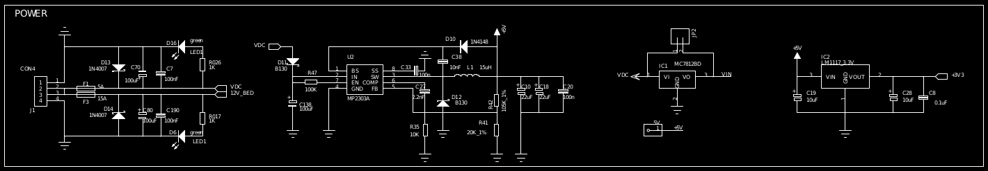

See:
This is a cutout with a power section from the GT2560 Rev A+ controller board. The board in version B has the same part.
Please interpret exactly what JP2 jumper does when the cap is put on it.
Writing that someone wrote something somewhere does not make sense here.
This is not an argument.
I could tell you to follow your advice and do a test. Unfortunately, I will not do that.
What do you think, why?
If you don't know, ask and I'll explain it in detail.
8-)

_kaktus_ wrote: Sat Sep 22, 2018 4:24 pm What do you think, why?
8-)
Opposite to you I don't claim to know what you are thinking. I try to guess. The jumper bypasses the 12V regulator, so the 12V output of the regulator gets pulled up to 24V. That makes it hard for this regulator to do its job. This guy here demonstrates that the 12V regulator survives this procedure. In my opinion the regulator survives it because there is no current flowing through it if the jumper is set.

Exactly. :mrgreen:
The output of the positive voltage regulator is connected to a different voltage.
Making the experiences you are telling us about is, in my opinion, breakneck. This is a crashtest. :lol:
It's the same if someone said: jump out of the window on the first floor - nothing will happen to you because it's low.
This is playing with fate.
Certain things are simply not done.
In someone's case, such an electronic system can work. And for someone else he doesn't have to. Such a combination can cause more than just damage to the stabilizer.
If I had to advise you something:
  • unsolder the chip first,
  • then you can safely put the cap on the JP2 jumper.
I recommend this solution. :D
Then the circuit will always work reliably.
For me this is a design error.
In the next version of the controller board it is eliminated.
