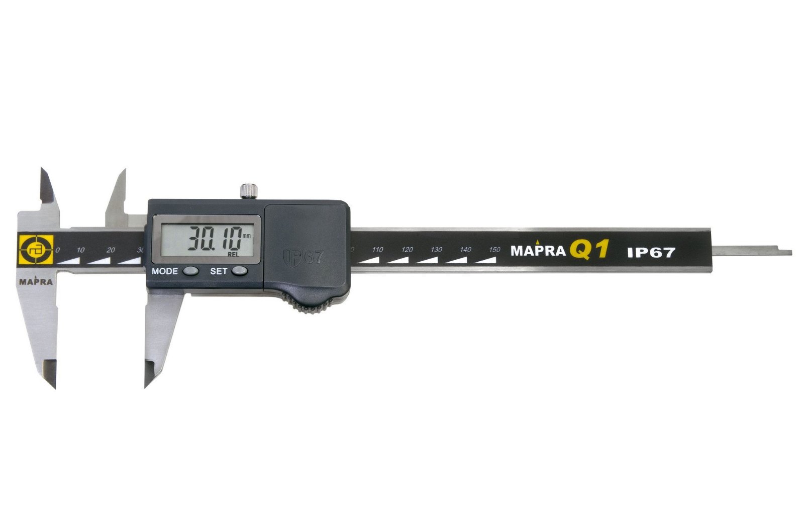

If you want to manually level the bed I would suggest you get a vernier. I am also not convinced the pre-heating is required. I don't bother with doing that. I do heat the nozzle though as usually there is a hard piece of plastic sticking out the bottom, not for "growth" due to heat! Just compensate with a slightly larger start gap.

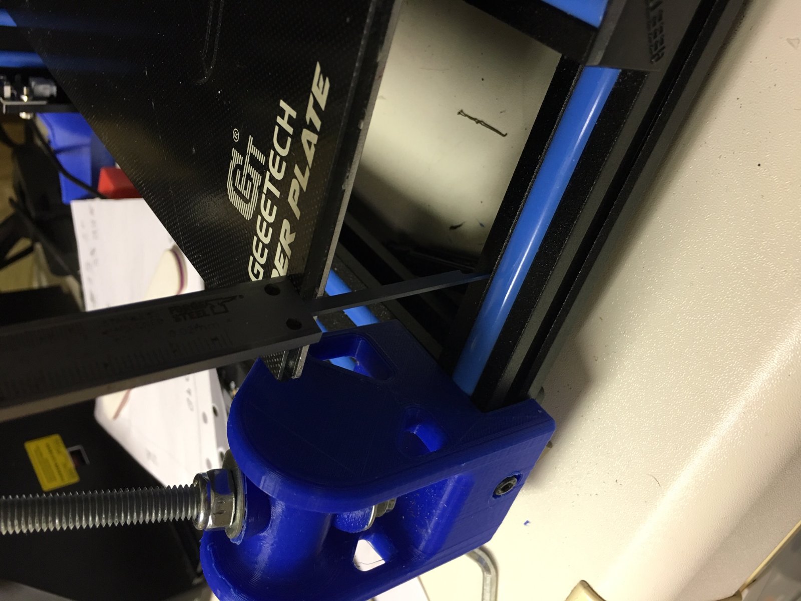

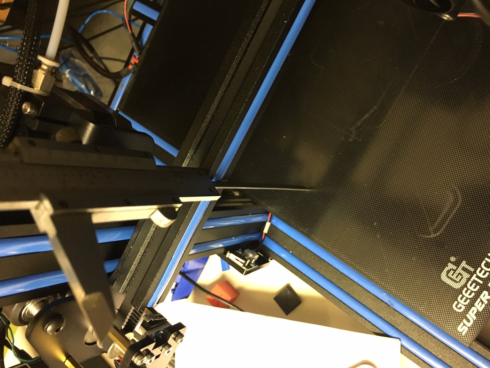

1) use the knobs to level the bed according to the frame.
Move the bed all the way to the front and measure the distance from the top of the bed to the top of the frame on each side. Make them even
Move the bed all the way back and do the same for the back. 2) Keep repeating step 1 till its as level as you like.
3) using the same method make both size of the gantry level ( I find I need to do this every other print as it does not hold level whilst off) Once you have done this your bed will be perfectly level. you can move your head and bed around with the nozzle very close to the bed to confirm. If you still having spots touch and gaps in other areas you have not done the above correctly.
If you still have issues and are really sure the steps are completed correctly, your machine my be out of wack. Then you will need to loosen it all and realign the actual frame.
