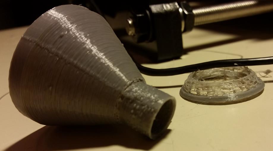

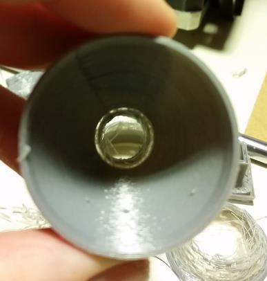

At first - really my bad - it was an error with the filament diameter setting, there was a typo, it was set to 1.5mm instead of 1.75. which resulted in the right object in my attached picture. I hope you forgive me and the thread should maybe get renamed.
Now I have a result like the left one when printing the funnel. As you can see, the rejuvenation part has Blobs and Zits, but the main 2 problems arising here are:
- as on the second picture attached, you can see that at the top of the inclined part, there are holes which you can see through
- the upper part looks really crappy, i have no idea what causes this

Re: First 5-10mm in Height are fine, then only thin layers
Hi
I wonder what is the wall thickness at this point of the model.
Hey,katze
I think you can check these:
1.Set the layer to 0.1mm,first is 0.3mm
2.Control the extruder move then check the nozzle clogged or not
3.Check the X carriage won't waving at printing
4.Check the Z axis wobbling or not
The wall thickness wasn't the problem but it seems as if the nozzle was temporary clocked - in between I also changed the slic3r settings; now the result is ok but I can not clearly say what caused the problem.

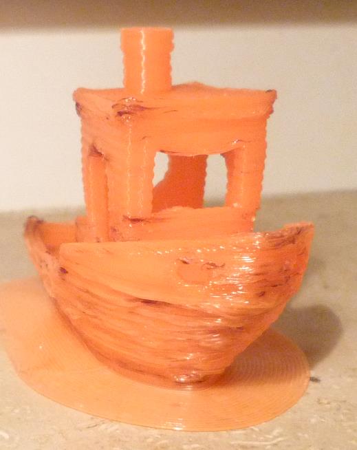

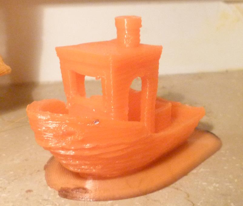

Now, printing the famous benchy3d ship the following problem came up: Printing the perimeters the underlying layers are "soft", the nozzle compresses them a little while printing on them. This results in an ugly surface and vaults.
I'm using the config file from here https://www.geeetech.com/forum/viewtopic.php?t=18536 with a heatbed temperature of 65°C and 195°C at the nozzle.
Maybe someone has any idea what is causing this?
Yours, katze
Hi
I would try to lower the temperature a little.
The model looks as if the filament was too hot during printing.
Hi kaktus,
I went down with the temperature step by step until I reached 180°C and still no luck. It even looks worse I think - while the black sprinkles are only from the black filament I used in prints before.

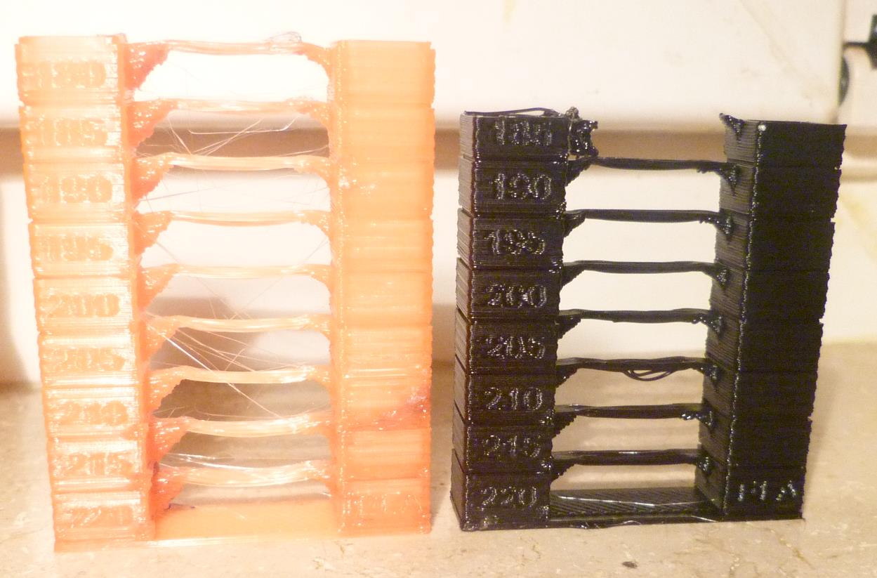

I then decided to print PLA temp-towers for black and orange as you can see in the attachment. Don't be surprised the black one ending too soon, the printer threw it over and I didn't want to print the model again.
Well now I have these towers (with temperatures ranging from 180 to 220°C in steps of 5 degrees) but I don't have an idea how to interprete the results. The orange filament seems to tend to stringing even if I never realized this in my other prints. Any ideas?
As a first step, I maybe should stick to one filament to not have another factor in the equation.
I think you can remove the tpfe tube off and check it.
Then check the cooling fan work or not.
