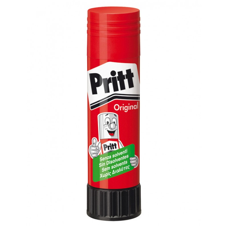

Re: First layer doesnt stick to bed ?
Try No Joke
