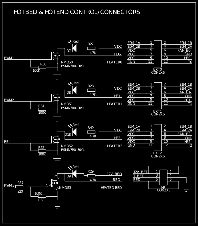

                  In order to consult with us, we will need a piece of the schematic diagram.
                  The LED D9 you are writing about indicates that the mosfet transistor is switched on and the heating is started.

                  When everything works as I expect it will confirm that the mosfet transistor that turns on the heating could be damaged. (Confirmation of LED D9 not lit).

                  If the D9 LED remains off, it may indicate that it is off:
                  • Fails to power the heated bed,
                  • Damaged NMOS3 transistor.
                  Check everything in order from the list to exclude each option.
