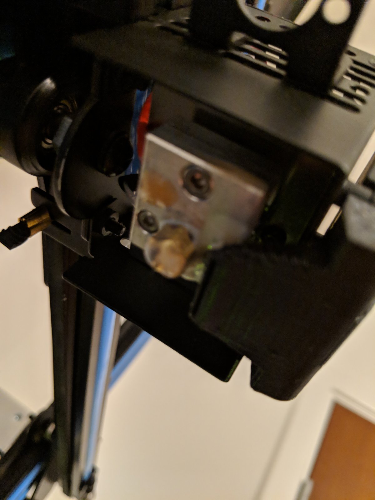

I unmounted the nozzle, to clean it.
Now it seems like it's leaking?
Any idea how to fix this?

you heat up before mount the nozzle ?

Re: Extruder leaking?
unscrew the nozzle in hot state, clean it and screw it back in hot extruder
Hello.
Heat it to the temperature you have set for printing.
1.Heating the nozzle to 220C
2.Clean the hotend
3.Re-tightness the nozzle and the throat
2.Clean the hotend
Leaving the heat at 220 all the time even when mounting again?William wrote: Thu Dec 13, 2018 2:53 pm 1.Heating the nozzle to 220C
2.Clean the hotend
Hi.
This is what it is all about to perform the assembly with hot components.
If you want to remove the nozzle off,you need to heating it to 220C at first.
