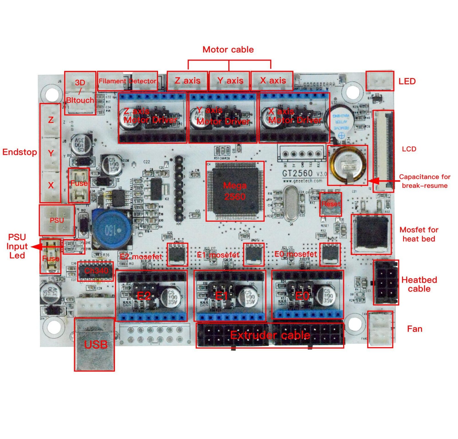

1.Try to upload the firmware again
2.Check the A4988 broken or not(You can swap them)
