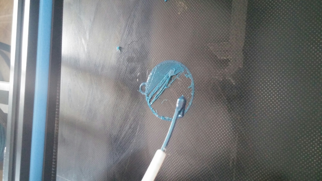

hello my buzzard gets blocked and makes me a big dough.
Can you help me?
kind regards
nozzle that clogs at 10m
- 20181219_163005.jpg (424.72 KiB) Viewed 5602 times

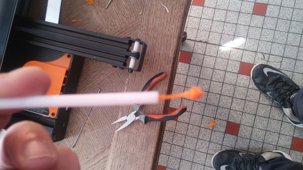

- 20181219_133418.jpg (550.2 KiB) Viewed 5602 times
Re: nozzle that clogs at 10m
Hello.
This can happen when the PTFE tube is not pushed deep enough.
It must be cut off evenly, it cannot be cut off at a slant
Geeetech filament, ABS only
Thank you very much it works again
