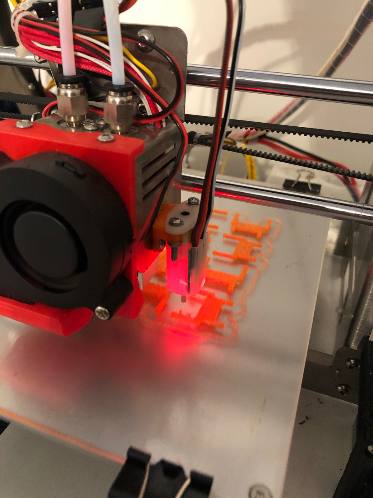

2. Print a mount for the 3D Touch sensor that is compatible with the Zonestar 3d Touch sensor
This actually can be found on the www.zonestar3d.com website. Url: https://drive.google.com/file/d/1xtvHDd ... sp=sharing. See picture how to place this mount.
3. After confirmation the mount fitted I installed the 3D Touch sensor without connecting it

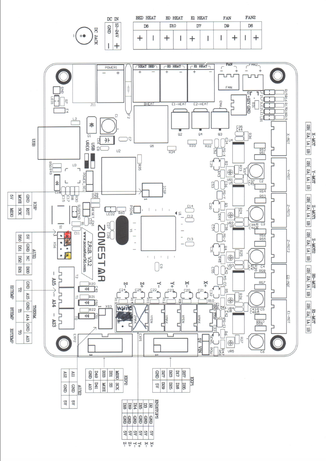

4. Extend the 3D Touch cables by using jumper/dupont cables female / female at least 70cm long. You need 5 cables, 3 for the servo and 2 for the Z- cable from the 3D Touch sensor. The other parts are in the package to install it.
4. Detach the existing Z- plug from the board, if you have the Auto level sensor (the blue proximity sensor sold with this 3d printer or as option) remove this also
5. Attach the white and black cables from the 3d touch to the board on the Z- interface (see wiring picture)
6. Attach the servo cables from the 3d touch to the board on the AUX1 interface (see wiring picture)

9.3 pins_ZRIB.h needs one adjustment as well, look for the line #if defined(IS_ZRIB_V5)
9.3.1
Code: Select all
#define SERVO0_PIN       20	//XS1(AUX3) Pin1
(this line is normally set to 42, but the ZRIB 3.1 board has D20 as PIN for the servo, see wiring picture)
Zonestar P802Qr2 3d touch mount.png (2.62 MiB) Viewed 9405 times
Zonestar P802QR2 3d touch wiring overview.PNG (1.27 MiB) Viewed 9405 times
