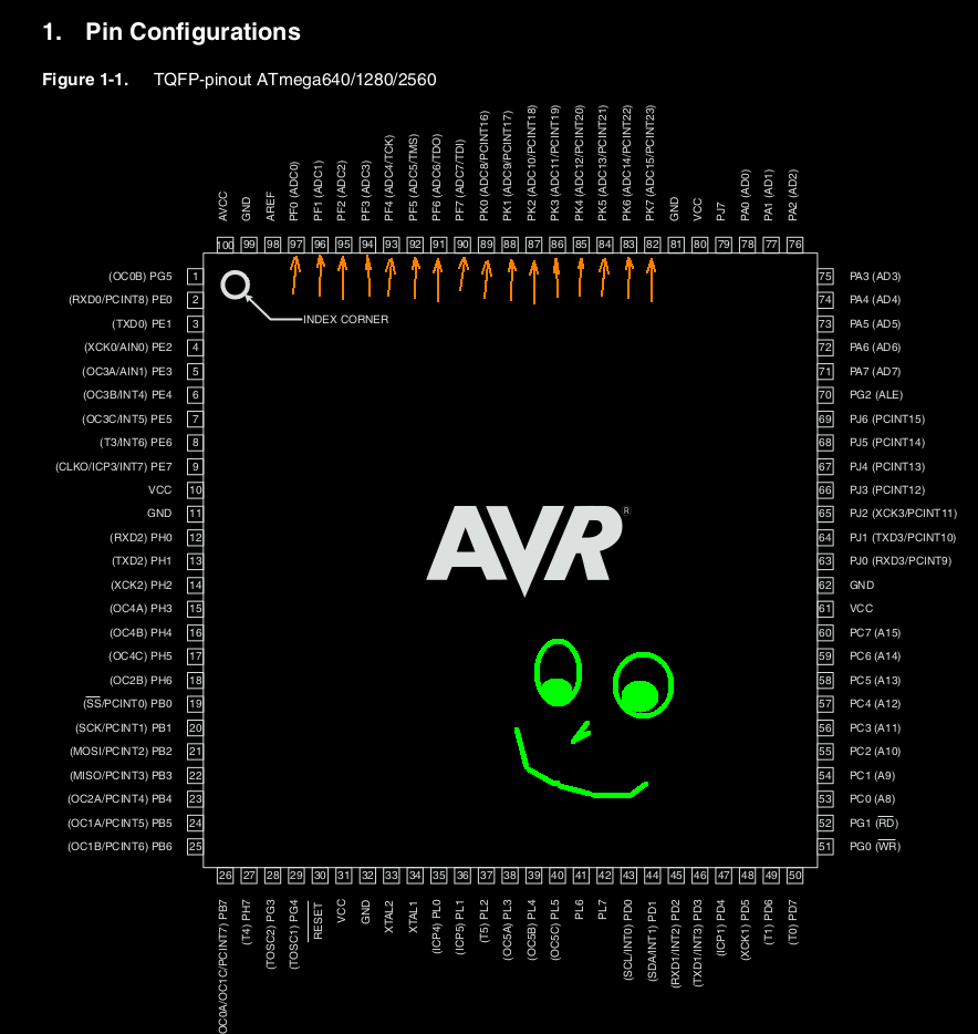

If this is not a problem for you, attach a file with the definition of µC leads to the message.
I will look at it in my free time. :roll:
I don't like Arduino environment and all the confusion around Marlin firmware ... well, but well ...
We will be interested in µC outputs, which have analog-to-digital converter functionality.
We have to check which of them are not used in the controller circuit.

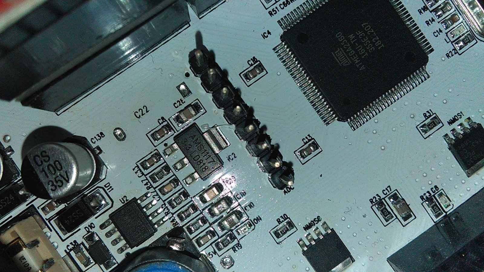

Unfortunately, the published circuit diagram of the controller board does not seem to be consistent in the PCB.
From one of the users of the forum (it's a pity not from the GT Team) I have a photograph of excellent quality:
I don't remember from whom I have this photo, but thank you beautifully, and I hope I can share it here. :P
You can see on it goldpin signed ADC.
Our task is to assign a new pin the necessary functionality, and a small modification of the PCB mosaic. :D
