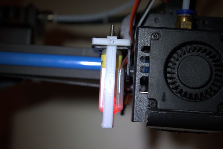

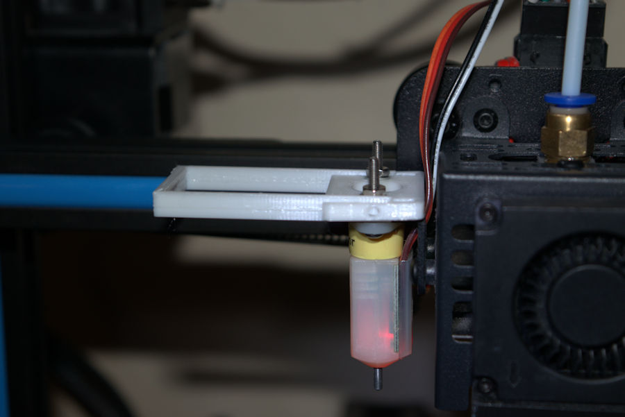

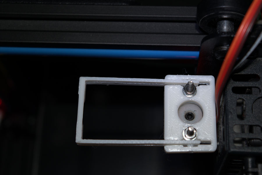

I have made a harness to fold down after the bedleveling has finished, I didnt like the Pin falling and messing up my prints when it vibrated too much.
I have posted it on Thiniverse if anyone wants to use it. This is For the The Newer A10 as its made for the 3D bracket that ships with the A10.
Hope it saves your prints it did mine.
https://www.thingiverse.com/thing:3430366

My situation isnt to do with the Wiring harness its a case of if the head moves to fast doing a small area of infill, it shakes the pin loose it drops and catches on whatever I am printing. The light in the 3D touch doesnt go off and back on its just the magnet cant take the Jerking/Vibration.
I made the pin support to combat the problem I was having, and it does the Job for me. So I thought I would share it because it is frustrating having it drop, but I had to make it so I could do it quick and easy after the leveling process had finished and before printing started.
For some it may not work as it all depends how far the pin is from the bed, with mine it has enough room to move the head and the bottom of my Pin Support is high enough off the bed to not scrape the filement that is being printed.
