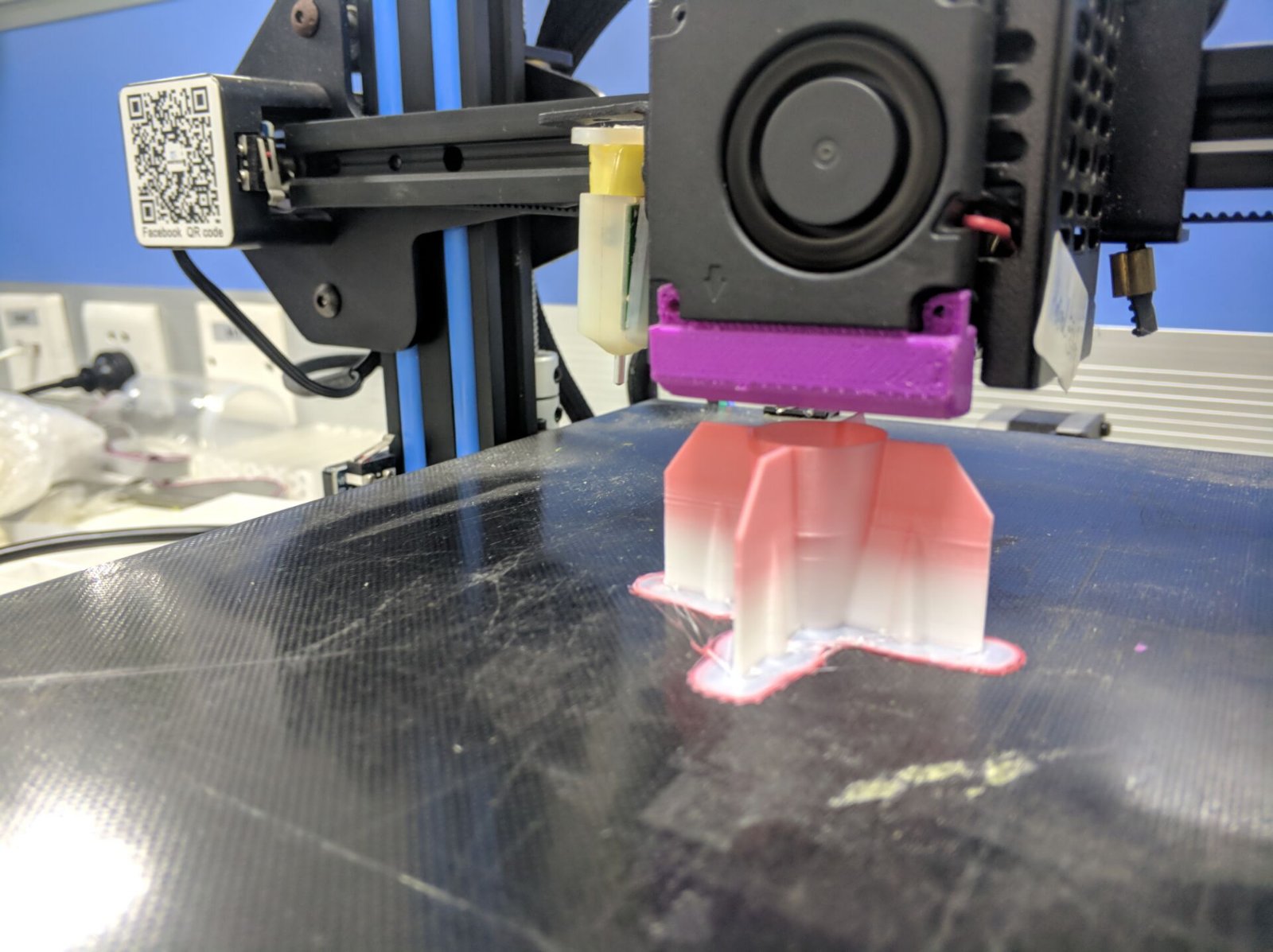

It seems work with vase mode

That's great William, the software works for you. Your vase walls seem to be quite thick, so perhaps the software works when the wall thickness is over a certain value.
