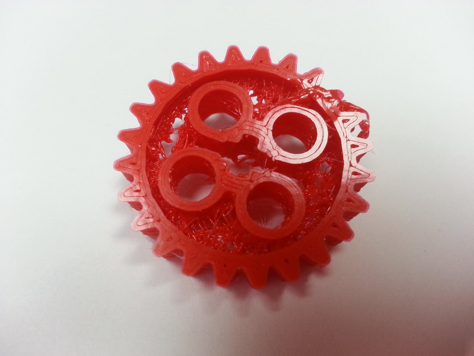

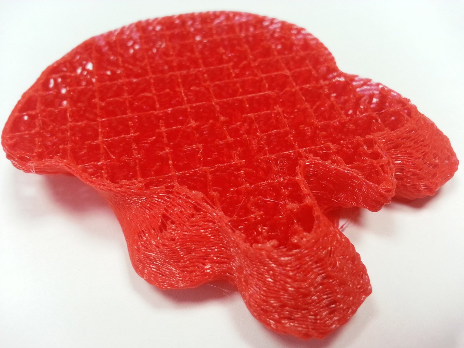

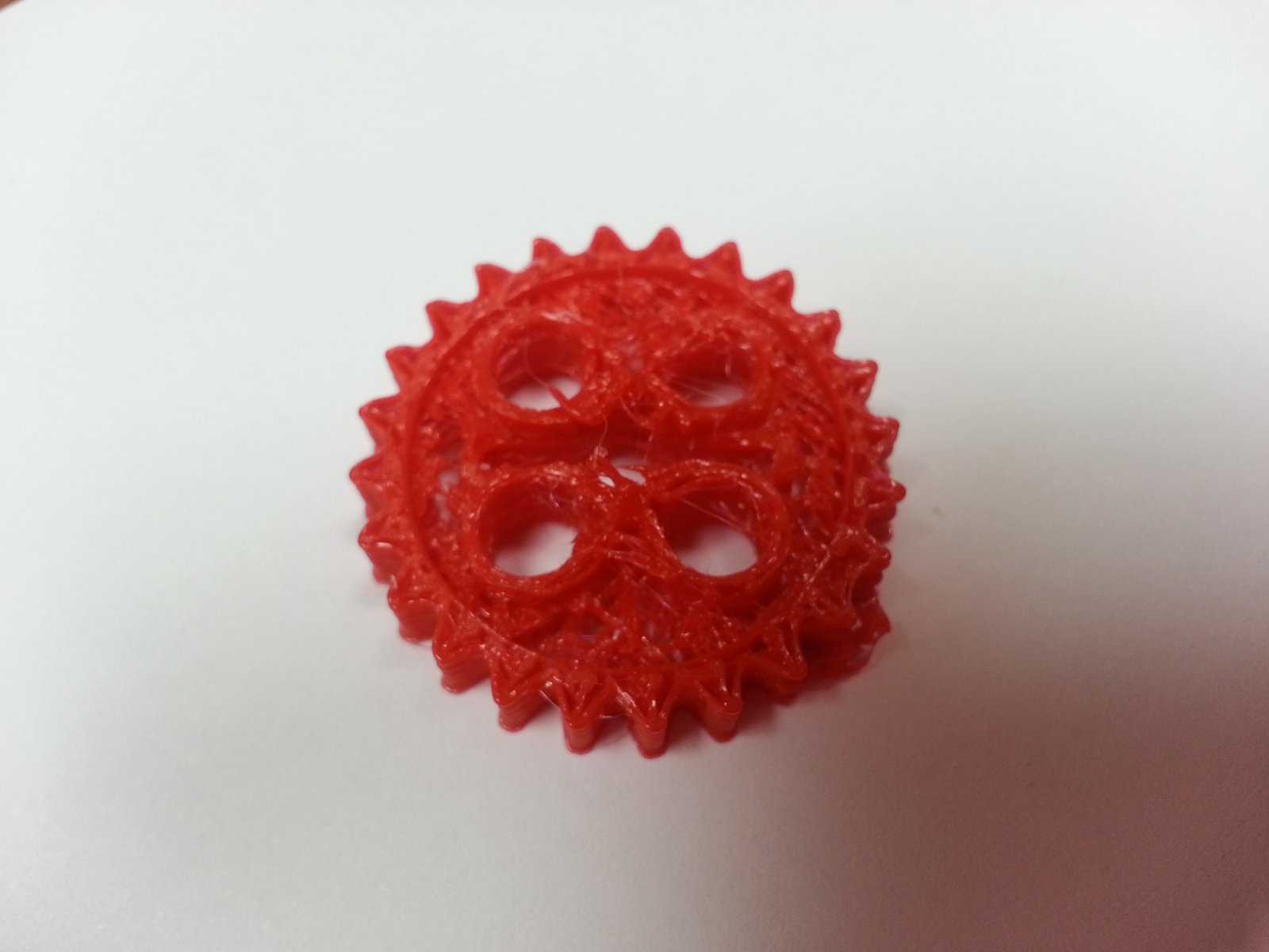

Hello.
I have a issue, the first layer seems to be ok, but I don´t close the infills (I have a 100% infill) and the last layer. I have tried to slow down the printing speed and also to increase the plastic feed.
Any idea about it thanks.

Thank you all. Problem solved using repetier host, and enabling the cooling fan
