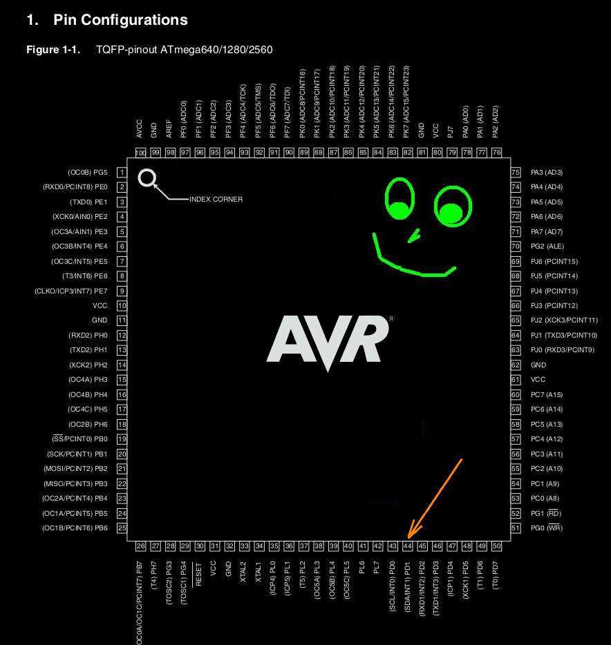

I've seen that in the arduino mega 2650 you can connect pin 44 with a 5V pin and everything works fine.
So I was looking in the schema of my GT 2560 rev.A where I can find pin 44 ... but I can not find it.
Can anybody help me?

Re: Power_Loss_Recovery on GT 2560?
Post by _kaktus_ »
Hello.
:mrgreen:
Voila ...
It is worth to make sure that this pin is not already in use.
Geeetech filament, ABS only

Post by maxlinux2000 »
TNX for that! :)
I will try it in next update to my printer
