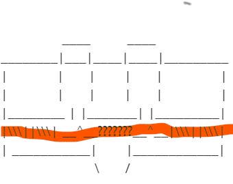

I have a request... can we have a picture/diagram/animation/or something explaining what exactly is going on inside the A10M hot end? There are many pieces, parts, and small bits that just aren't on any other hardware I've seen. For the life of me, I can't seem to get the chamber clear of gunk and the buildup has caused every one of my prints recently to look like hair (not spaghetti, hair).
Searching the internet I have found 2 semi-instructional how-to videos on the topic that have the same look & feel the official Geeetech productions. The first "how to clean" doesn't really bring any hard-hitting "halleluja" type tips or tricks... in fact, I believe it ends with the narrator saying he was lucky he was able to order a new hot end configuration. The orange level in my type-sketch a complete mystery! Why the little screws? Why have the __/\__ circular corrugated disks inside the throat end stops? Is this chamber pass-through? Should i be able to see the other side when I'm done cleaning it? I can't seem to get anything to work in there and I've about had it : (

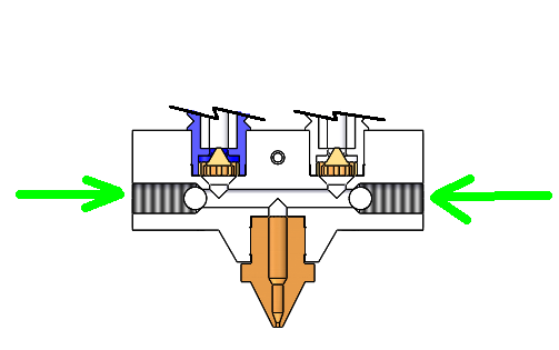

Hello.
See the following figure. .
When you unscrew the screws at the opposite ends, ...

So ,
If I remove the 2 screws , I should see through , after cleaning ??
Sorry , I m not very good in English and I m not sure I ve really understand the « reply »
Re: A10M Cleaning the Heater Block is a NIGHTMARE
Hi.
Yes
AirBee wrote: Mon Apr 15, 2019 8:41 pm ...
Yes

!!!!!! in my head ... there is 2 screws on each side ....
From your photo, what are the circles?
Also, the screw threads have worn down from having to clean this thing out so much. How can I get a new heater block? I tried asking someone in sales, but the only thing they told me to do is to buy a whole new hot end configuration- which is way more than i need.
