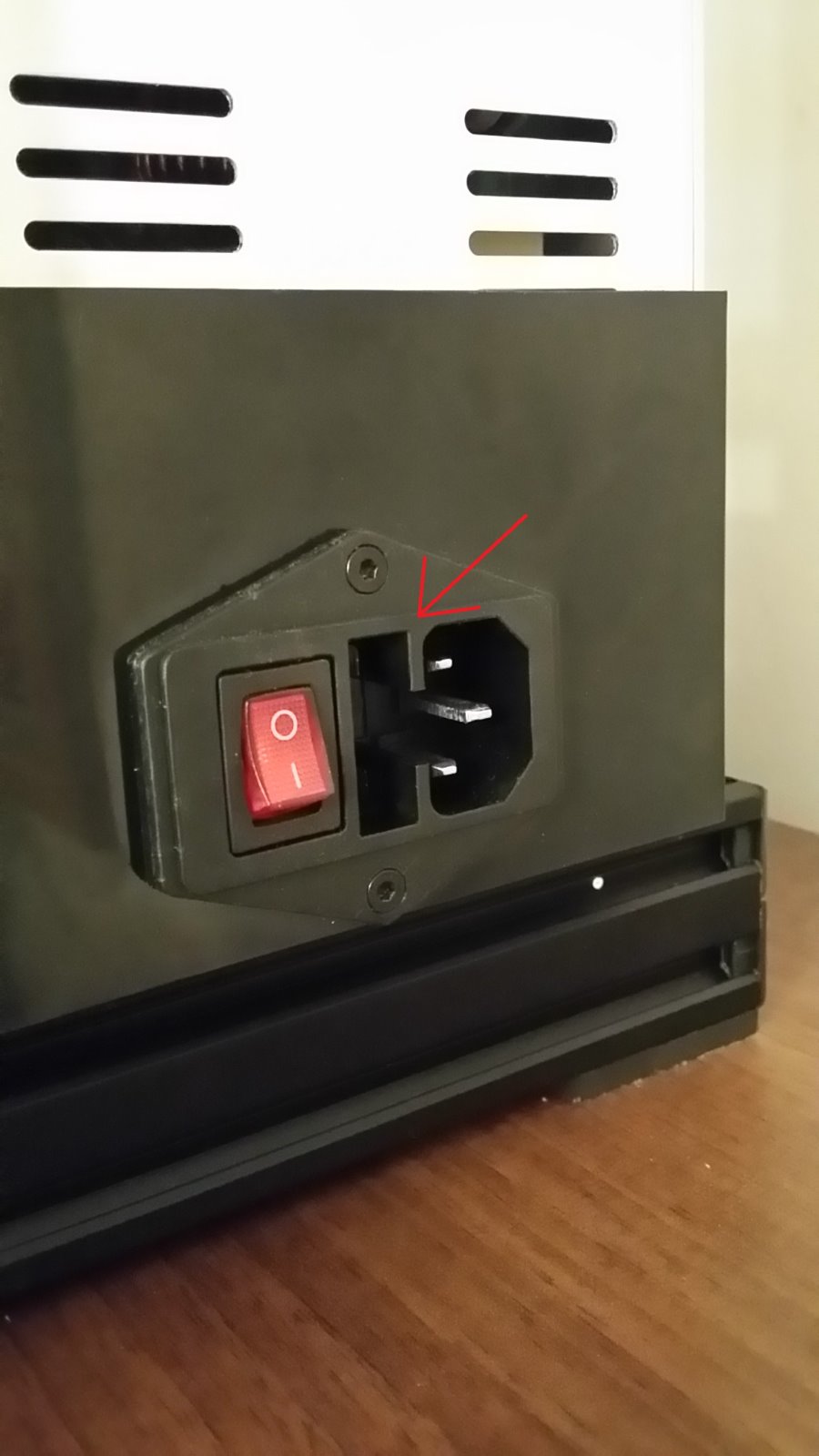

Hi, can anyone tell me what amperage the 250v fast blow fuse is on the A10 printer, it's the glass fuse in the black plastic holder inbetween where the pc style power lead plugs in on the power supply and the illuminated power switch.
Mine has blown and it's distorted the embossing on the metal part of the fuse to the extent I cannot read it, it looks like it may be 10A but I want to be sure I get the right one to replace it.
(the power supply also blew out which is what killed this fuse in the first instance, I have just received a replacement psu from geeetech but it was just the supply and was not supplied with the black plastic shroud, I don't want the new psu to die so obviously need to install the right fuse)

It's the fuse that goes where the red arrow is pointing in pic
- Fuse A10.jpg (107.17 KiB) Viewed 6246 times

Re: Power supply fuse
The FUSE of it is the 250V 10A type.
You can replace it with the new.
