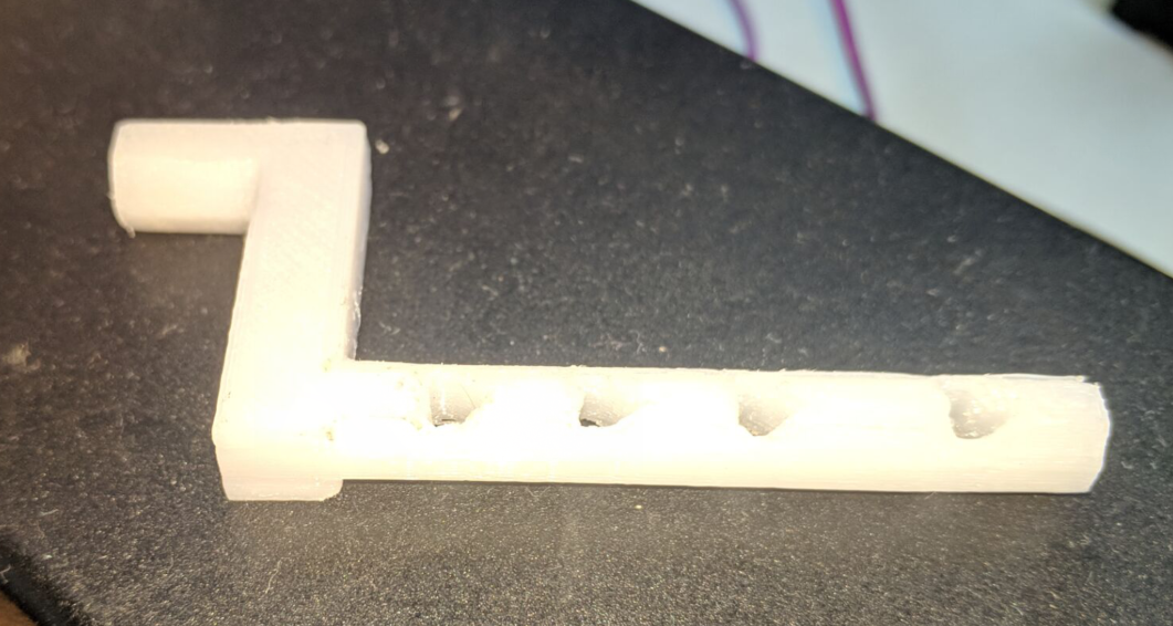

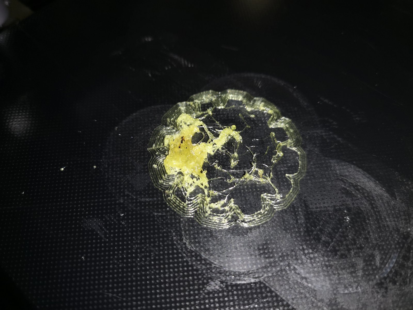

Printing the first layer seems to be ok. But then it looks like the speed is geeting up much faster than the 45mm/s. Especially when printing/filling small areas it feels too fast. The result you can see on the photo. It seems like not enough material is coming. So I tried to raise the temperature in steps up to 250°C. But the results are the same.

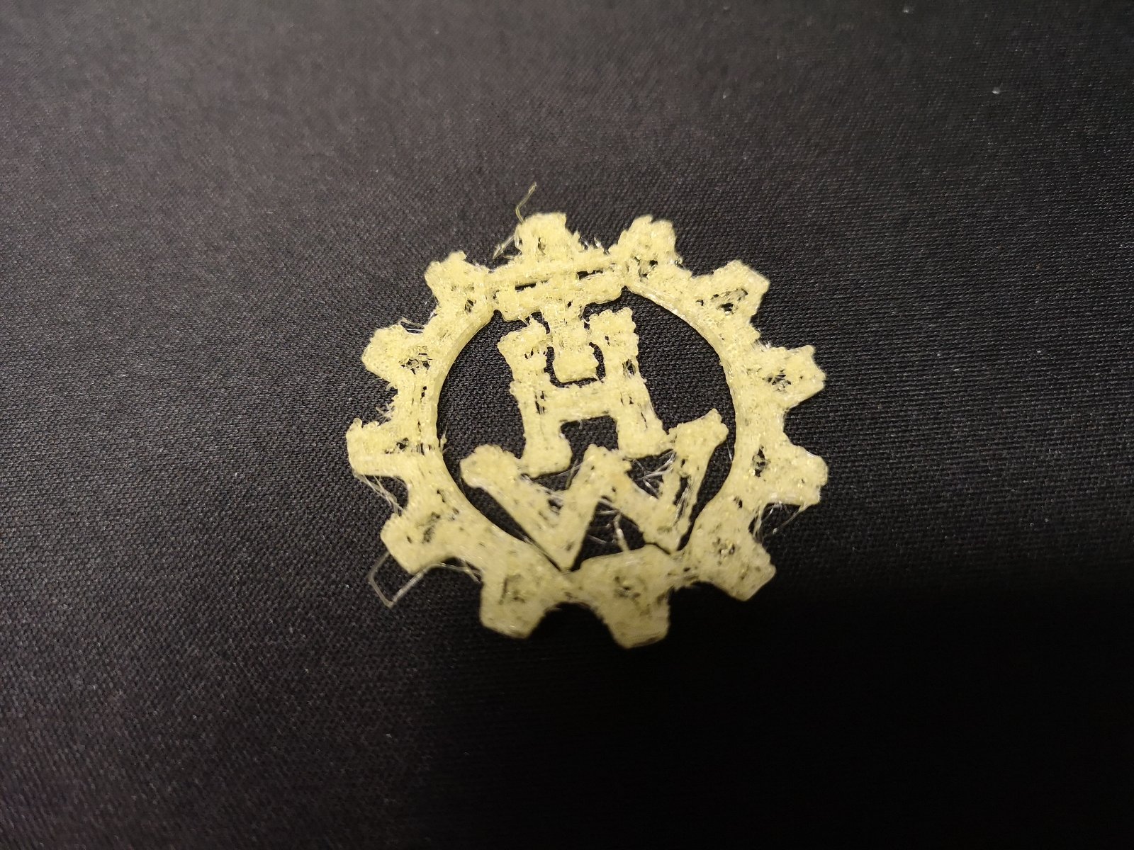

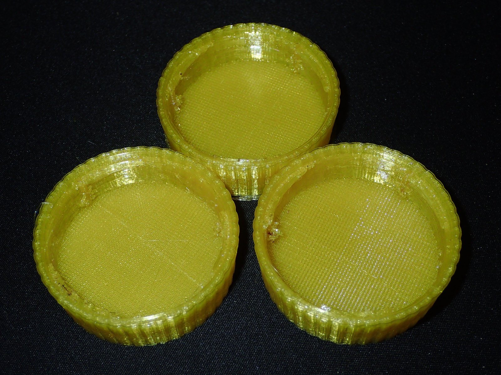

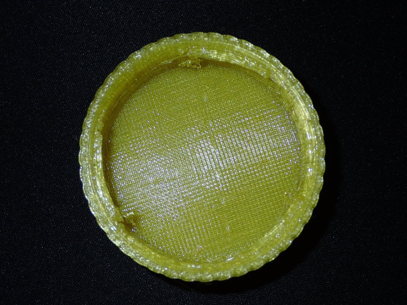

The results are much better than the first tries as you can see. The only thing I would like to correct are the small overhangs at the end of an layer especially at filigree parts.
I tried to adjust the values for retraction distance (1,8mm actual) and Coasting Distance (0,4mm actual) but it isn't still optimal.

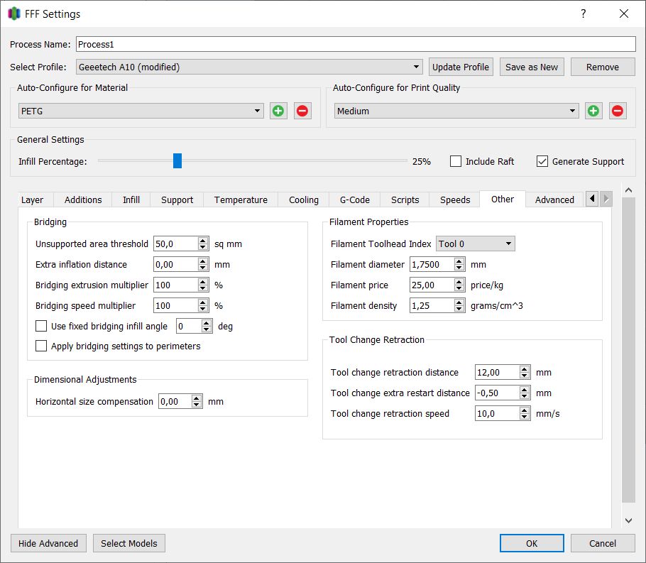

This may indicate that there is an error in the settings.
Have you checked what is the set diameter of the filament in the slicer settings
Geeetech filament, ABS only
Re: Problems with printing PETG
The settings for the filament seems to be ok.
