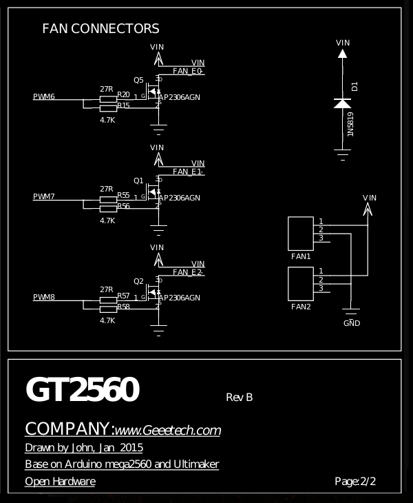

Hello William, thanks for the answer.
The open question is now why the fan (for board cooling ?!) does not start anymore when switching on the device.
Unfortunately I am not an expert in electronics, but if I understand the circuit diagram properly, there is no temperature sensor for controlling the start of the board cooling and the extruder cooling fans.
What is the most likely cause, Is a component on the board GT2560 Rev B defective?

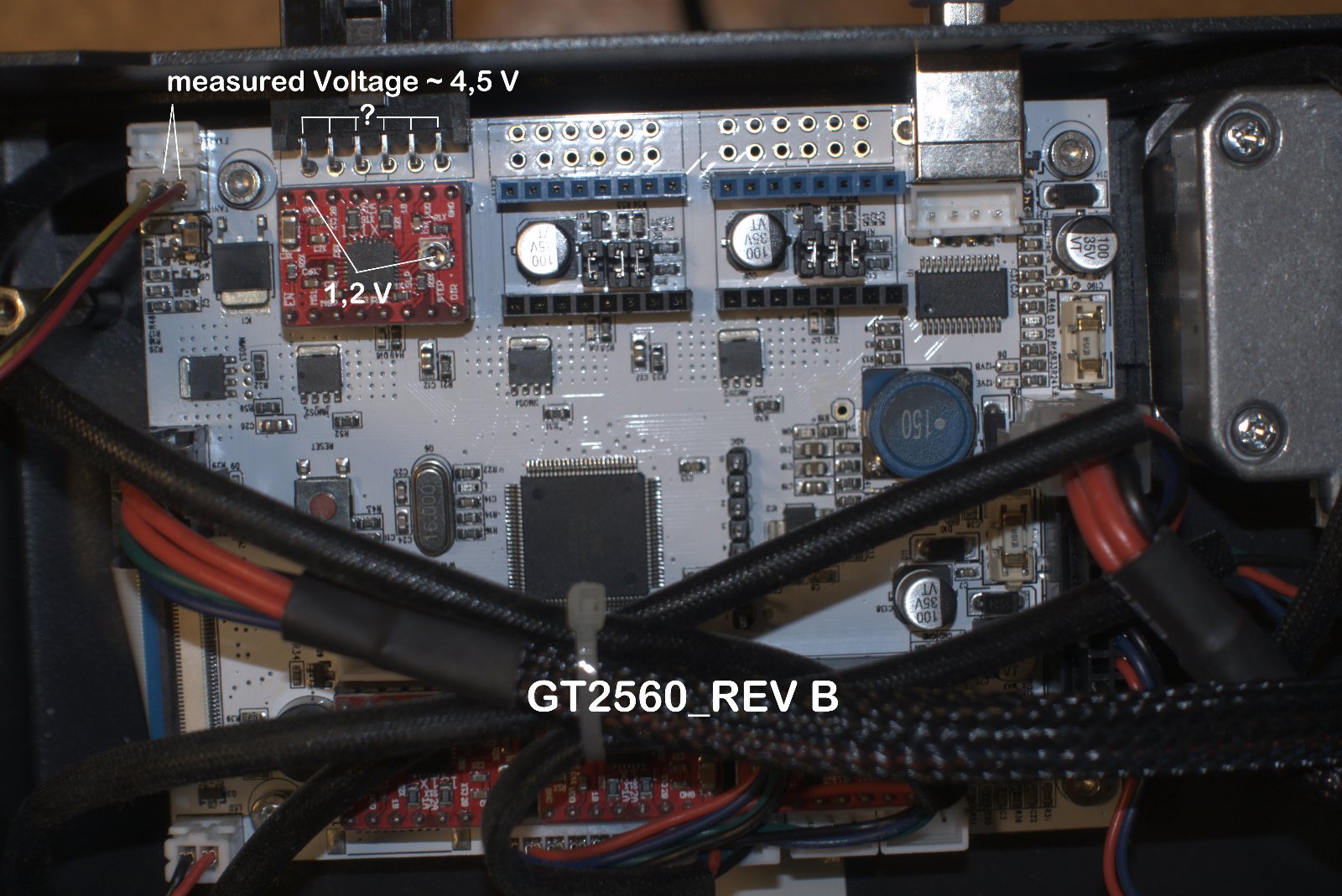

Hello William,
in the meantime, the three fans have resumed their function, but only for a short time.
It is noticeable that always all 3 fans are affected!
An additional problem has occurred with the fan failing again. The extruder stepper is no longer able to transport the filament. Nozzle and pipe are new. With the Extruder retracted, the filament can be pushed through the hot nozzle with little force. The stepper creates a clacking noise, but does not feed. Its not a friction problem, it seems that the torque is not sufficient. The filament is moving forward and backward in a high frequenz.
Attached a photo of the Board GT2560 REV B.
I did a few measurements and found that the electrical voltage at the fan socket is only about 4,5 V which seems to low for a 12 V fan. The reference voltage at the motor driver for the extruder drive is about 1,2 V.
Is there a plausible explanation for the low voltage on the fan socket and for the fact that all 3 fans are affected?
Which measurements or tests I could do to localize the cause?
Please help.
Regards, Werner

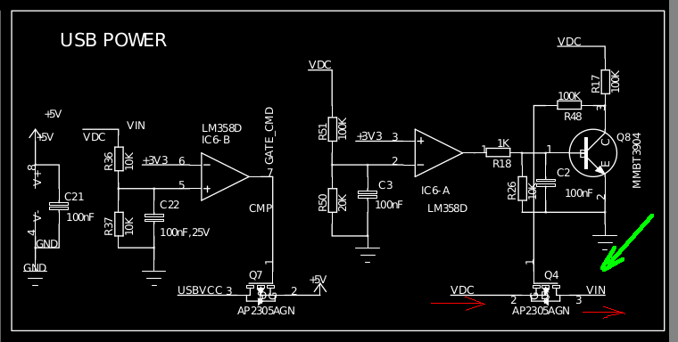

Hello.
Maybe the following schematic diagram will help you to understand how it works. . .
With a green arrow, I marked where the VIN potential comes from.
If the voltage at this point is too low, as you have noticed, you already know where to look for a fault
Of course, your main power supply must work properly.
