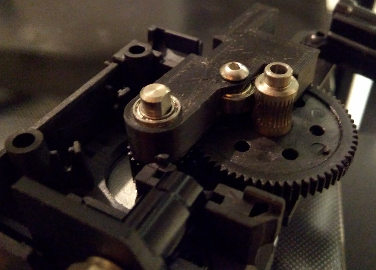

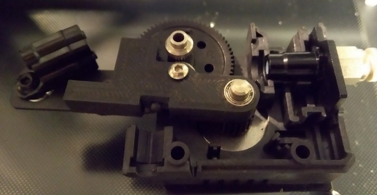

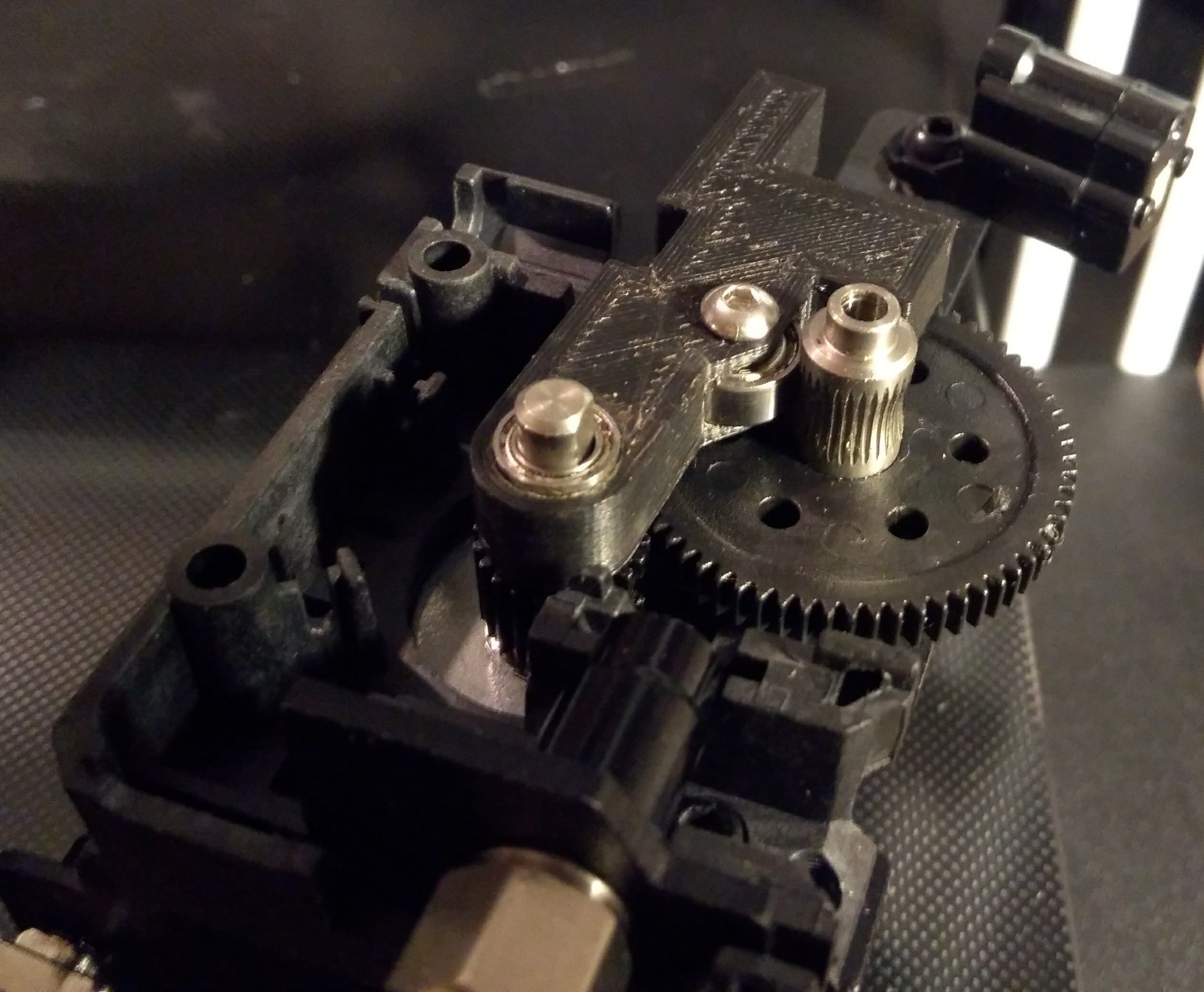

BR365
Posts: 57
Joined: Mon Apr 16, 2018 7:24 pm
Re: Different E-Steps for E0 and E1 possible?
Post by BR365 »
Extruder repaired with printed spare part.
Newls
Posts: 28
Joined: Mon Apr 15, 2019 5:22 am
Post by Newls »
Where did you get the print file for this?
I could really use it.
Mine broken at the same place.
Newls
Posts: 28
Post by Newls »
thanks Vert good point about PLA.
I only print in PLA so i'd have to get some ABS.
I'll look to prototype it in pla first unless someone's got the file.
PLA may work ok if baked but i'm not had a lot of success with baking PLA for strength. Also it shrinks so this will make it harder to calculate.
I've put on a aluminium extruder at the moment which works really nice. I though i was buying a dual drive extruder but it wasn't. Anyway works really well apart from the fact the Esteps are drastically different.
To overcome this issue at the moment i'm having to put in an M92 when using T0 and set it back when I want to use T1.
If i get the part fixed i'll post the part on thingiverse.
Newls
