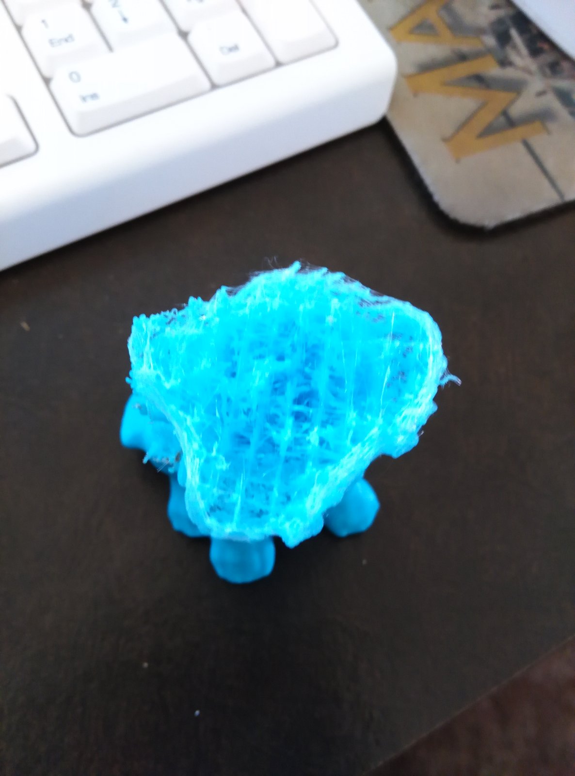

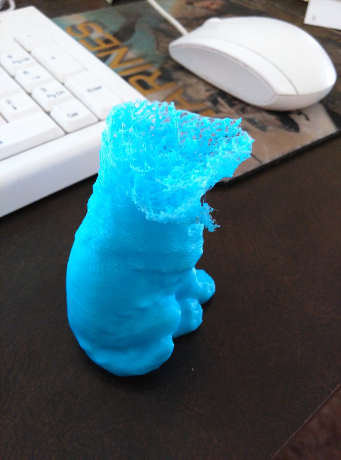

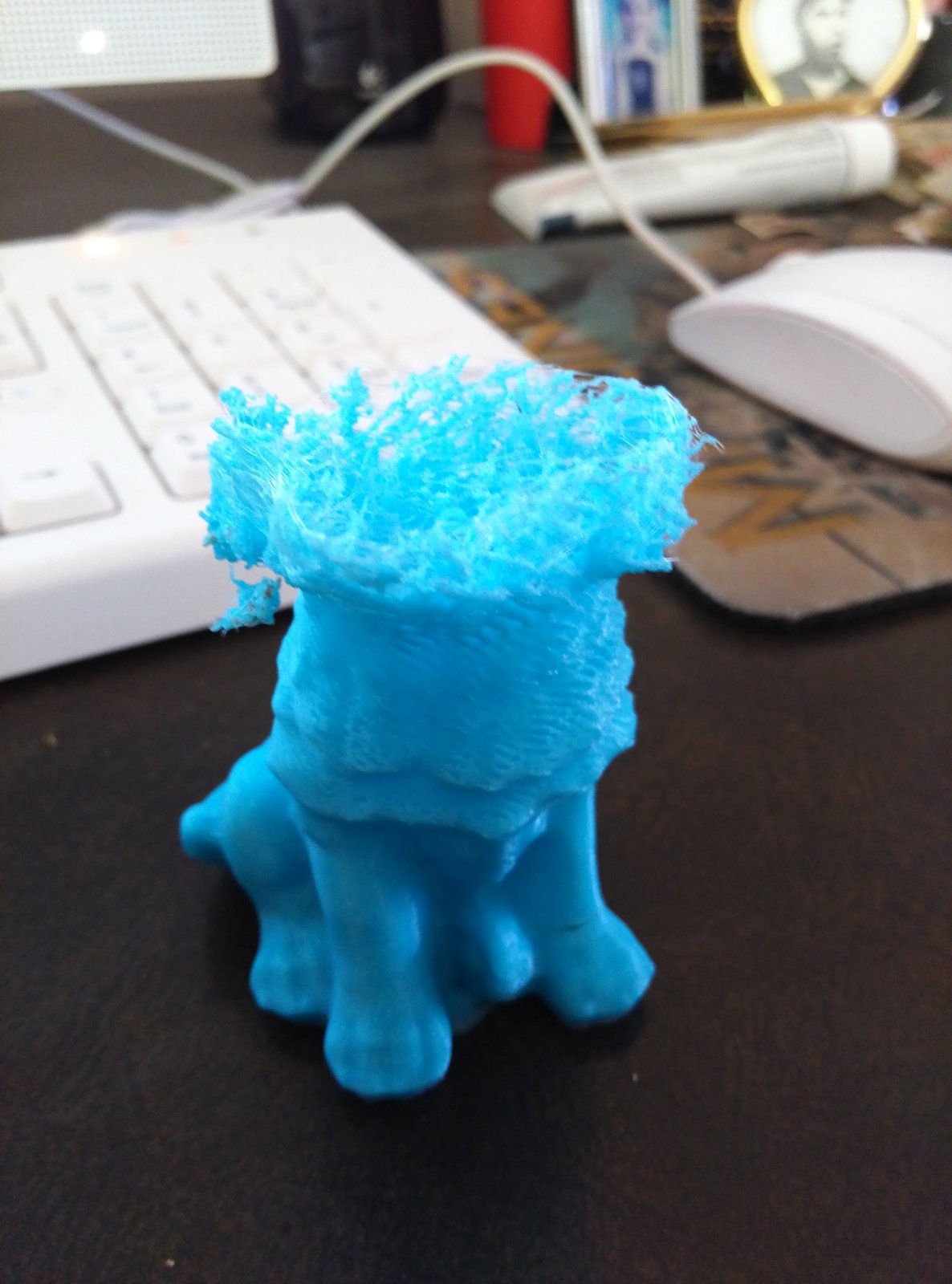

Why? This is a dual printer and were only printing one color. It printed great for most of it then went stupid

We got it. Its a duel feed extruder. We only had filament on one side. The top of the dog uses the second feed.

Perfect timing on this question. I just printed the dog last night and had the same issue when I took it off. Couldn't figure out what happened. Yup, I only loaded extruder 1.
