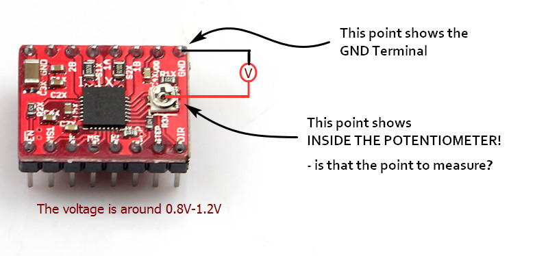

What value should be the voltage and between which terminals to measure? I see there are 4 wires entering in the motor.
Thanks.

HI,The picture shows the driver board on the motherboard. You can try to adjust the voltage of the driver board to reduce the heat of the motor.

I understand that...but HOW MUCH to reduce it? Which voltage (between which pins that voltage has to be measured)?
If i turn that potentiometer, i will not know how much I changed the voltage, unless I can measure it.
The diagram says voltage should be between 0.8 - 1.2V, but it doesn't say between which terminal it has to be measured. I see the black line drawing coming from the GND terminal, but the red line drawing goes to the potentiometer... I hope I am making sense.
Re: MeCreator 2 - X Motor very hot!
Hi, the position measured is the position marked on the graph.

I am not sure I understand what the diagram shows ... because the red line goes in the center of the potentiometer, which normally is just a bushing (the rotation point). So, if one terminal is the GND terminal, which is the other terminal?
Please check the attached image, it explains what I'm trying to say.

Yes and you can try it.
