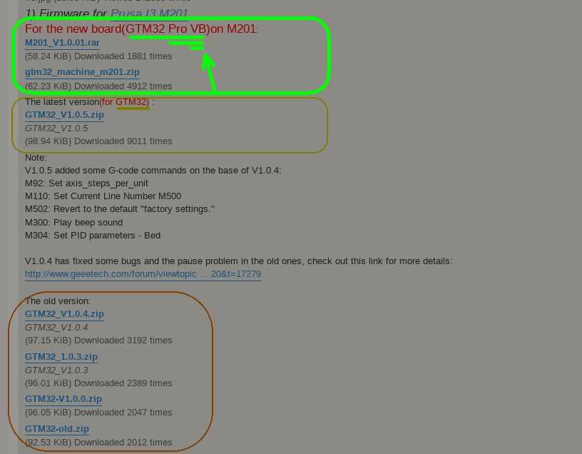

Firmware page is maybe a little bit cryptic :-)
Thanksfully a between bracket "(for GTM32)" is supposed to make the difference between the pro and the "not pro" (too bad, the not pro seems to be more powerful than the pro. :lol:
Firmware Page :
1) Firmware for Prusa I3 M201
For the new board(GTM32 Pro VB)on M201:
M201_V1.0.01.rar
(58.24 KiB) Downloaded 1879 times
gtm32_machine_m201.zip
(62.23 KiB) Downloaded 4911 times
The latest version(for GTM32) :
GTM32_V1.0.5.zip
GTM32_V1.0.5
(98.94 KiB) Downloaded 9009 times

Nice the red color "(GTM32)" definitively help to understand the difference / border line between the two boards :D

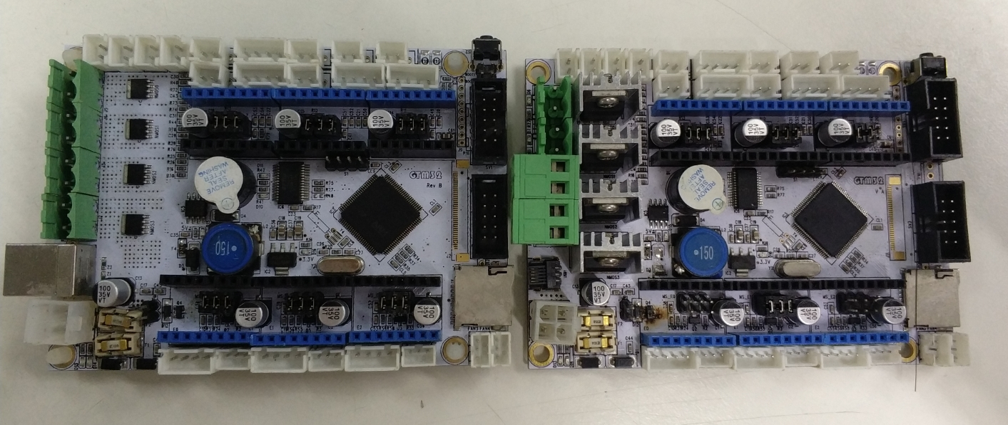

At the turn of the century, when the M201 was manufactured, its controller board was improved.
The first produced unit - it was a few years ago, had a different controller than the M201 sold now.
If you look at it carefully and do not act in a hurry, you will understand.
Otherwise, you will make more mistakes in the future.

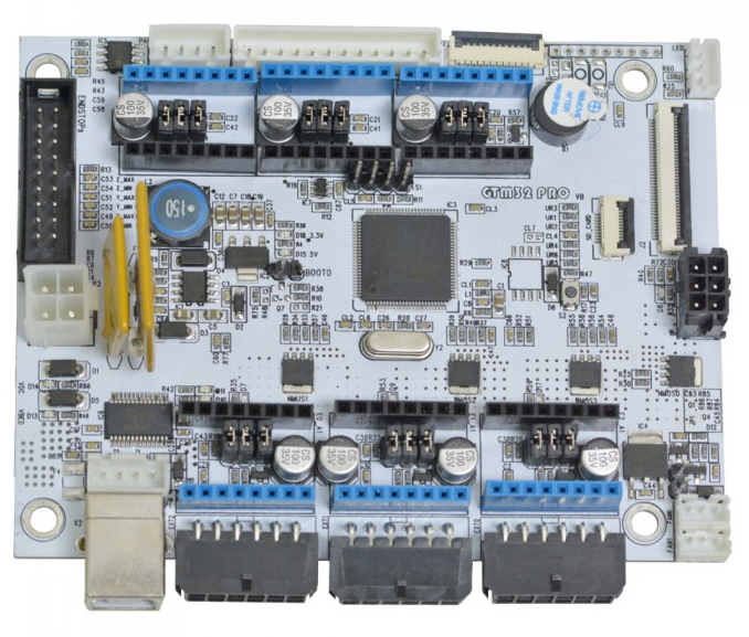

I guess you have a GTM32 Pro vB controller model.
Below are images of older versions of the controller. These are GTM32 vA and GTM32 vB.
