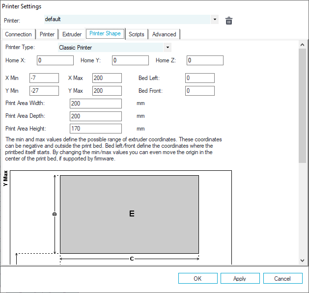

#1 The offsets I've used in the firmware suit my machine and you will need to verify your's as they differ machine to machine. I also had to match these offsets in the Printer config (screen grab attached) so that manual control works correctly after homing. See line 885 Configuration.h
#2 To get a better belt alignment on the "Y" axis I flipped the stepper meaning I had to reverse the stepper direction so check your motor direction carefully. See line 850 Configuration.h
