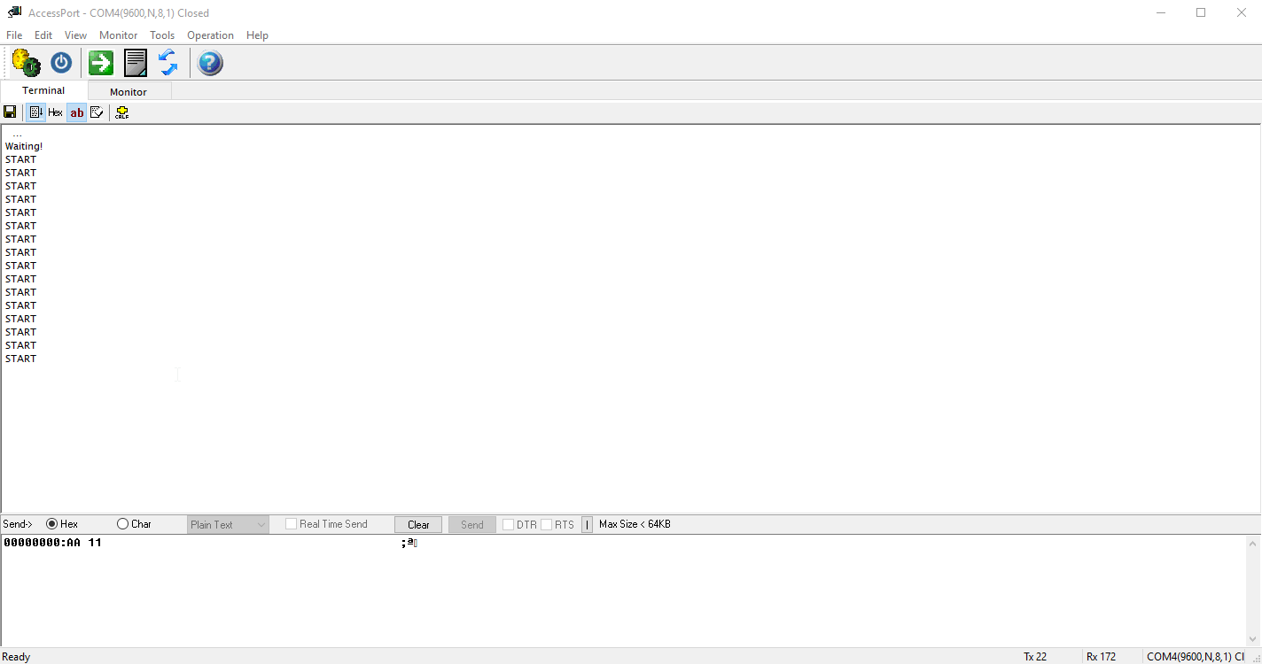

here is a screenshot of AccessPort where tried testing the system. i entered AA 00 and the device responded with "waiting!" and then I entered AA 11 so start recording, and it displayed start over and over again and there was no way to stop it without unplugging the module.

Hi, you can check the connection between voice recognition module and USB-TTL module is correct.
TXD pin on voice recognition module should be connected to RDX pin on USB-TTL module.
RDX pin should be connected to TXD pin.
If the connection is correct, please check the baud rate of serial software is set correctly.
The baud rate for the voice recognition module defaults to 9600bps.

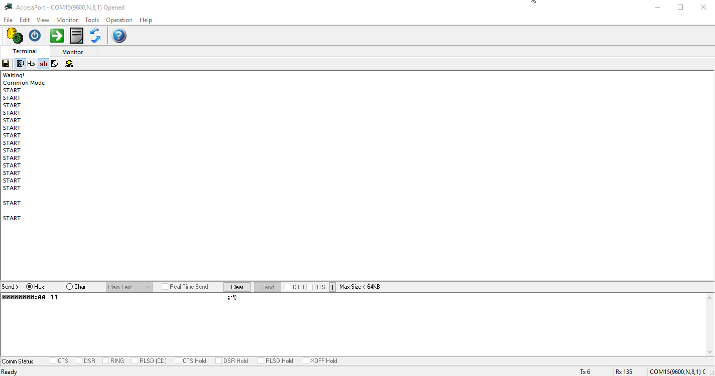

You can refer to this:
Write aa 36 in the send area of the serial port software,
and then click Send to switch the serial port receive mode to Common mode.
Finally, the 0xaa11 command is sent to enter the recording of the first group of voices.

I set the device to common mode again, and i got the same result:

You can contact your sales to replace it.
