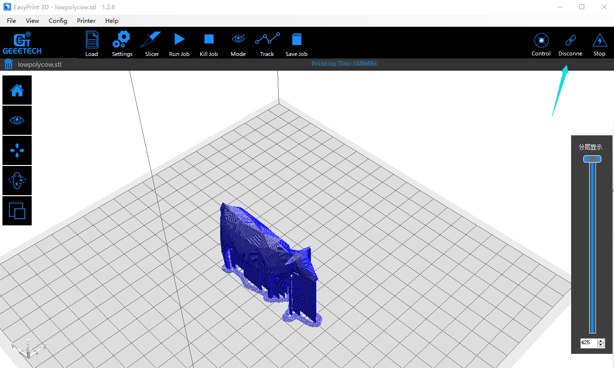

When I load in a gcode file into EasyPrint 30 and set the COM port and the printer to I3ProB I click Run Job and nothing happens. The printer has the CH340 chip and I have installed the drivers for it.

Hi, You need to connect the printer and then slice the model.

I connected, clicked slicer, then when it was done I clicked Run Job and still nothing happened.
Re: Not printing
Hi, Have you chosen the correct port to connect?
Can you provide your specific slice video?

I am connecting to COM 3 which matches with the driver installed:
https://drive.google.com/file/d/12-lg-i ... sp=sharing
Video: https://www.youtube.com/watch?v=UOg-EDFN14Q
Re: Not printing
Hi, You need to connect the printer before slicing.
After connecting, you can see the hot end
and hotbed temperature status of the printer at the bottom.

I have tried this and still nothing is printing. The extruder is staying on 25.9°C and the off bed is staying on 49.6/50°C.
Re: Not printing
Hi,Are you setting up the printer?
Set the print temperature in the extruder and hot bed in the consumables?
