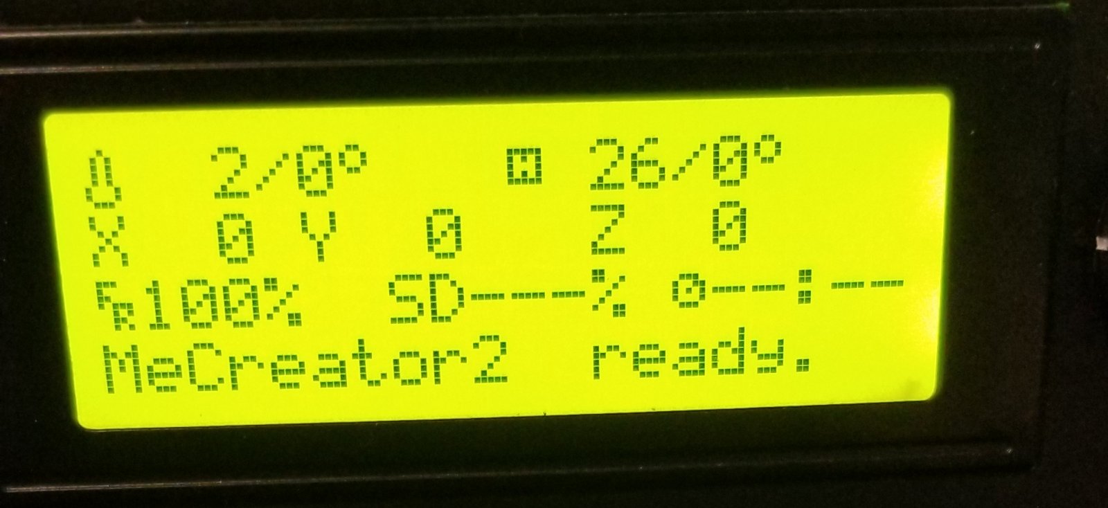

I have a new symptom though. The temperature reading had been normal so far but now it is reading very low. I'm sure my printer is not near freezing. Does this mean i need to order a temperature sensor?
Re: Extruder not feeding enough plastic
Hi, You can check if your hot end thermistor is fully connected;
If you don't have a multimeter, try unplugging the hot end on the motherboard.
Check the display. If the temperature is negative, the motherboard has no problem.
It may be necessary to replace the hot end;
If you have a multimeter, you can measure the thermistor at the hot end.
I hope this can help you.

I replaced the thermistor and everything is working again. I'm not sure why the temperature took so long to read incorrectly. I had already been having trouble for a week at that point. Perhaps it was failing a little at a time. Anyhow, it works now so thank you for your advice.
