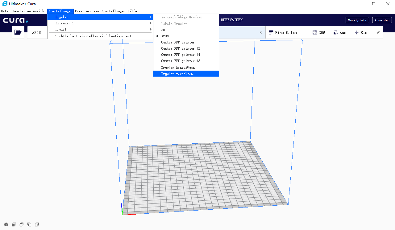

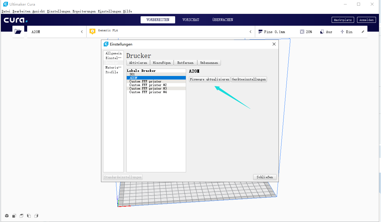

Then use the CURA slicing software to connect to the printer.
Use Settings-printer-manger printer
Update the firmware.
I hope this can help you.
