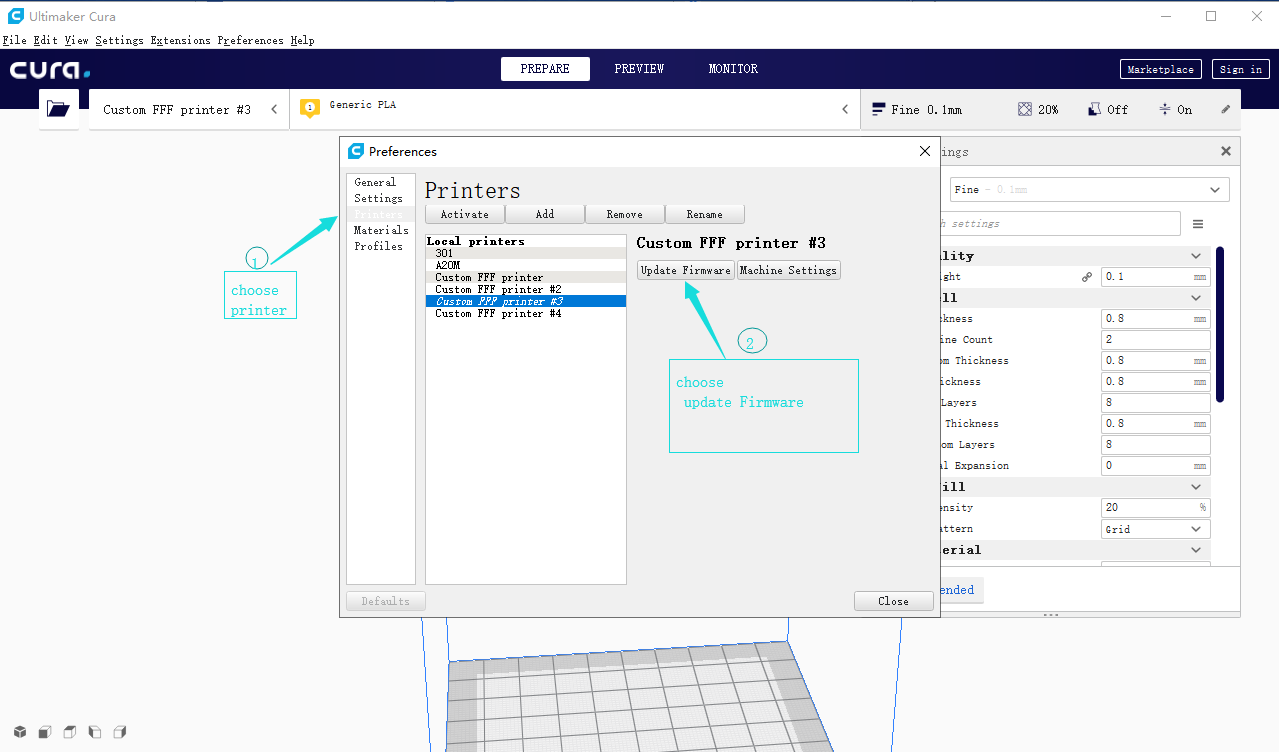

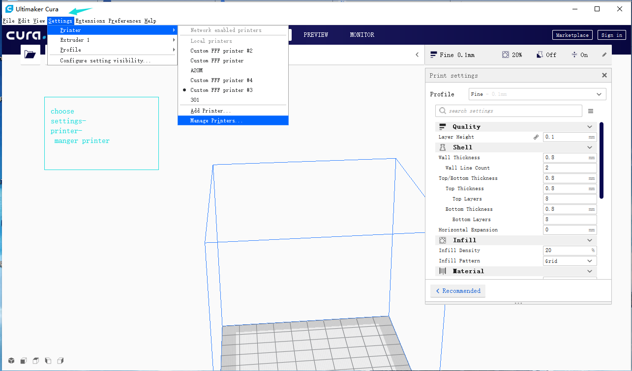

If you feel that your firmware is not uploaded correctly,
you can try to download the compiled firmware in hex format on the official website
:https://www.geeetech.com/download.html?download_id=30
and upload it using Cura slicing software.
Connect your computer via USB,
Select Settings-printer -manager printer
Upload the firmware
(Image as a reference)
I hope this can help you.
