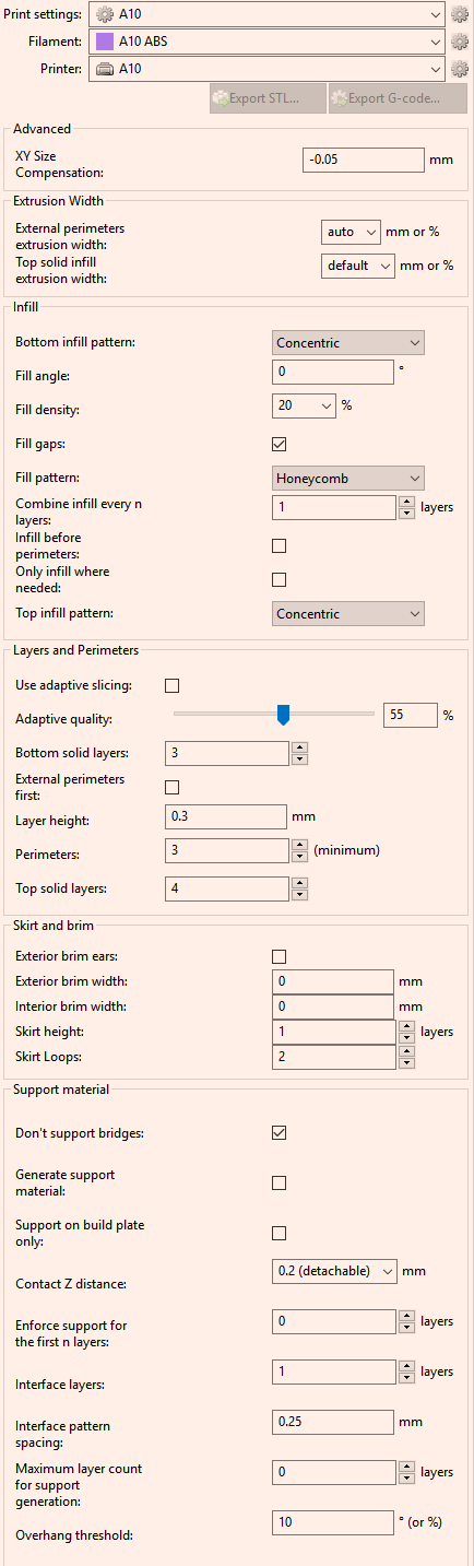

So there is luxury printing profile to do that with plastic sheet (and did not melt it with leak-stop process), ABS (tested) and PLA (untested). Original configuration parameters is from unknown source (I think that it is from someone thingiverse, but unsure). In archive is config bundle together with slicer config folder (c:\Users\yourname\AppData\Roaming\Slic3r). Today I was make some changes to gcode initialization, but did not confirmed yet (printer is far away from me now).
A10 menu.png (52.7 KiB) Viewed 8384 times
