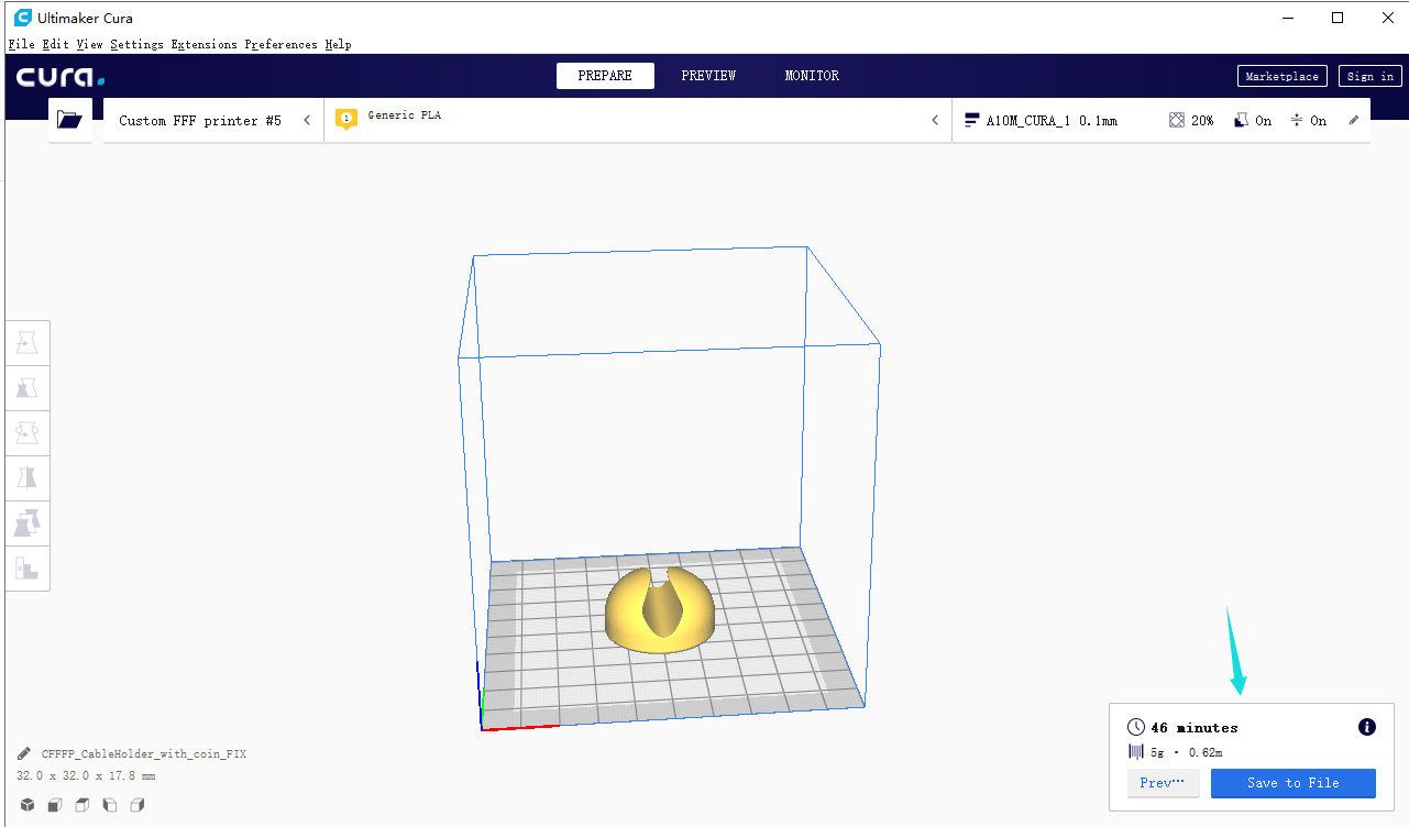

I have tried formatting the SD card using SD Card Formatter. I can save the gcode to the card from Ultimaker Cura, then I put it in the printer SD card slot. It says Card inserted on the display but there is no button to print in Cura?
Re: Extruder and bed are not heating up enough
:D Hi, you can refer to this:
