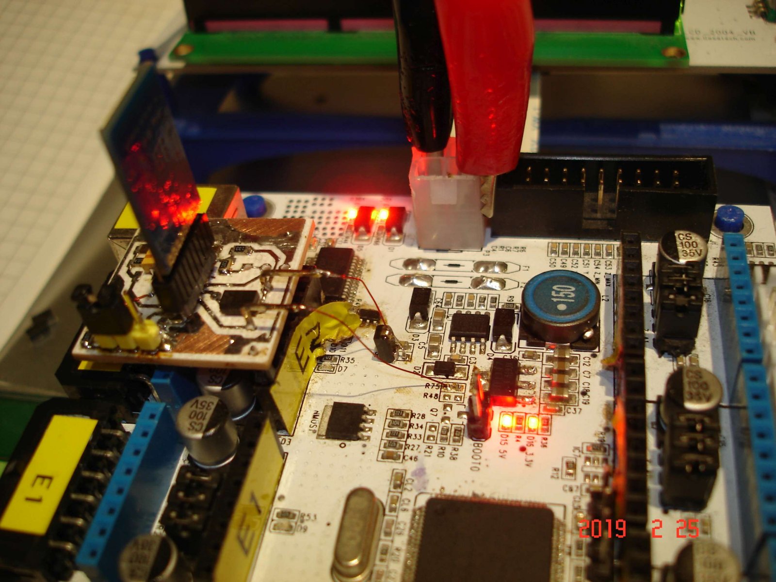

I started implanting ESP in my printer once.
GTM32 Pro vB.
Later I didn't have time to continue this project, and in addition I broke the PCB of the controller.
Now I have a new one. When I finish the modification I'm doing now, I'll go back to wireless communication in my controller.
This is a hardware solution. It also contains a trick, so it does not require any interference in the firmware.

Re: GTM32 Mini S WiFi Pinouts.
Hi Macflame.
Thank you for the good word.
There is never too much of that.
In the course of the first tests, the electronics were as follows:
