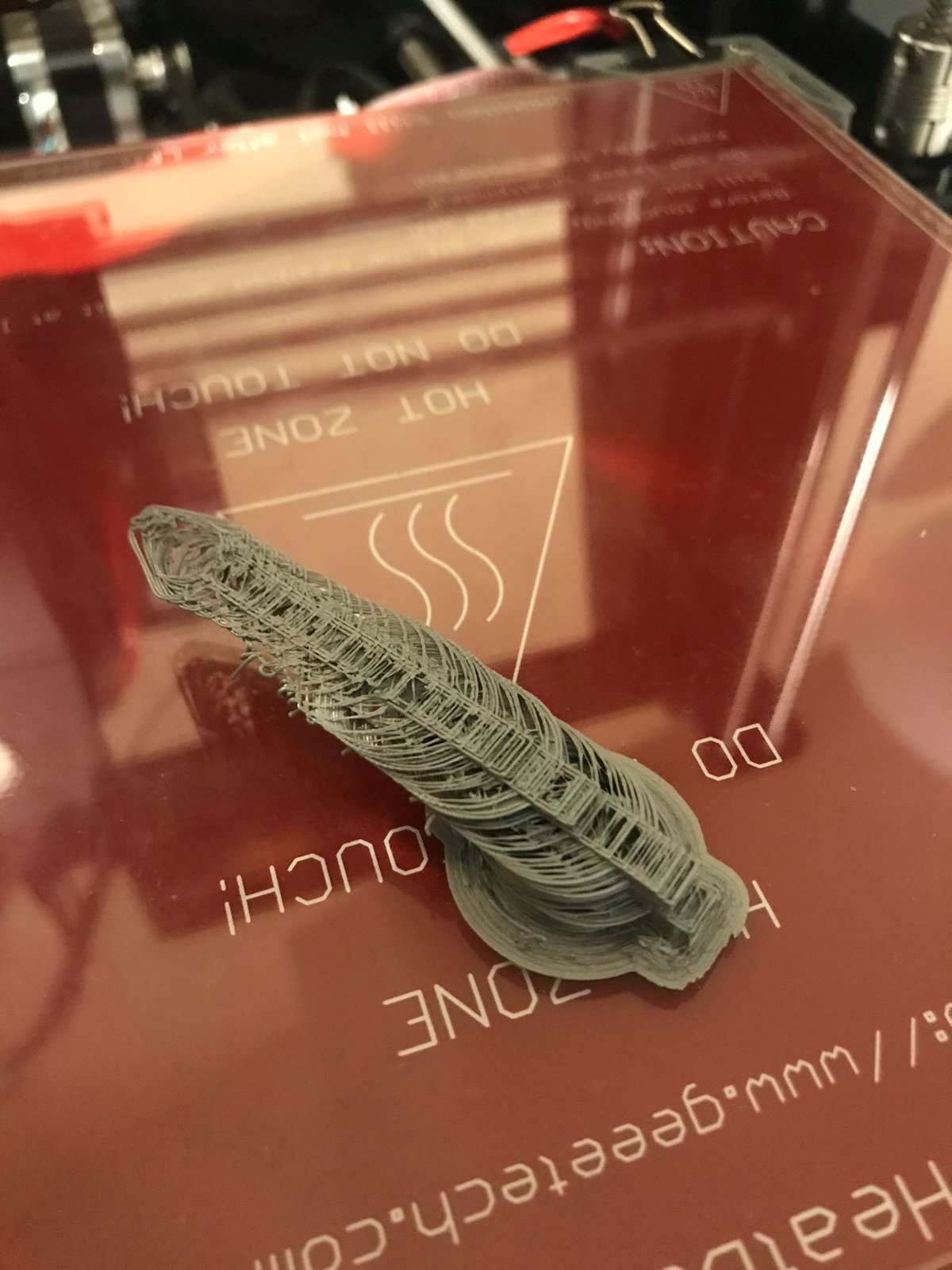

hello,
ive recently upgraded my geeetech i3 pro b with a bl touch (which by the way was an absolute pain and took forever due to the number of issues I kept having)I'm running the newest marlin firmware 1.1.8 and its leveling perfectly however I'm having a bizarre layer shift issue. I've never experienced any layer shift issues before but now it seems to print perfectly for the first like 20 layers then suddenly start to continuously shift each layer back along the y-axis. I've checked the bearings, the y-axis motor, and belt and it all seems fine. what i find most bizzare is that the first 20 layers come out perfect then it starts to shift. if anyone knows what could cause this or any suggestions please let me know your help is greatly appreciated
thank you
by the way, my slicer is cura
thank you

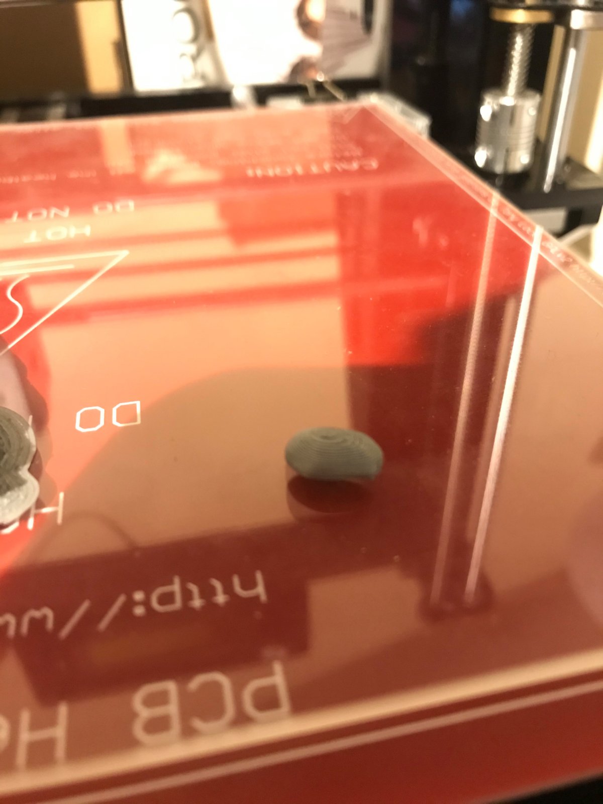

Re: Layer shifting
also here is some pictures.
- prints perfectly for the first like 20 layers
- 74705077_2378150212423654_1553028391475609600_n.jpg (159.59 KiB) Viewed 7374 times
- 1.2.jpg (218.85 KiB) Viewed 7374 times

Re: Layer shifting
Possibly overheated electronics, if there is not mechanical problem. Or bad gcode, if you have plenty of CPU cores then gcode is sometimes really mad. Limit CPU cores under 10 in slicer options.

Re: Layer shifting
I've added tl smoothers if that affects anything, and it's a 2560 board, ill try limit the cpu thanks.

Re: Layer shifting
okay, so I decided to try just printing with the USB straight from my computer on cura instead of using the sd card and so far it's printed really well. I'm gonna try something bigger and see if it still performs well
