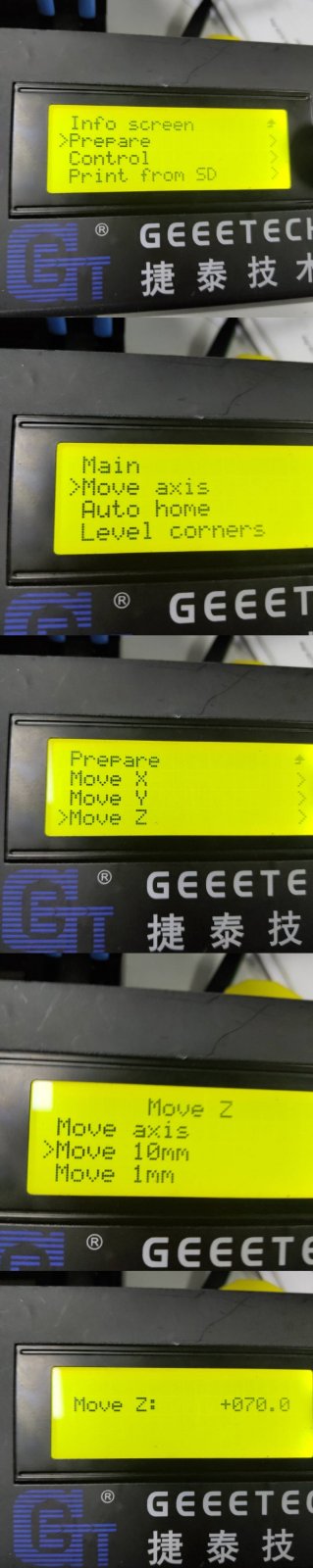

How do you do this other than turning off the printer and manually moving bar, extruder, and bed, which I hate doing fearing I'll screw something up. I had to cancel a print, but there's no "return home" option in settings, and the extruder just stayed where it stoped, making it difficult for me to clean up the mess. Sorry for such a simple question, I'm sure I'm missing something.

:D Hi, You can try moving the z-axis up a distance on the printer's screen.
Then clean up the consumables.
