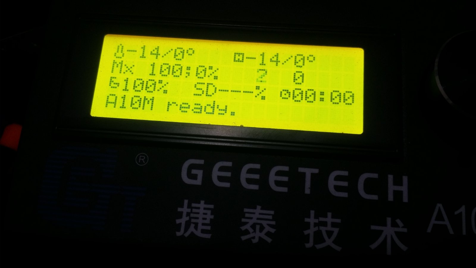

Yes i dont have a voltmeter unfortunately
Now I removed both hotend and bed cables from the controler board and the printer reads -14/0 in both
Does that means that the controler board is ok ???
And i've changed both thermistor (100 Kohm) and the heater cartridge (24v 40w - 6x20mm) .. and the problem still exists .. what else should i do ????
Note : i couldn't find the 6x30mm heater cartridge anywhere here .. can that be the problem ??!!!!
And want to order parts from the website it self .. do u support shipping to egypt ?
